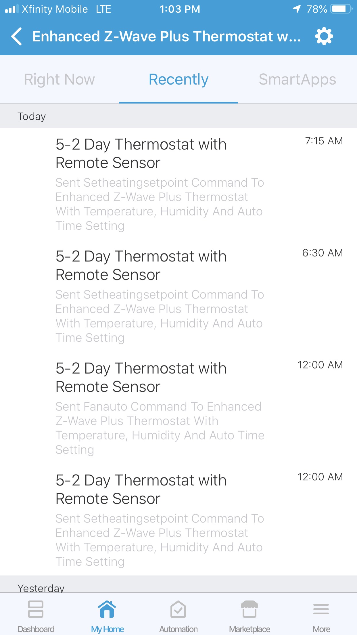

I added my CT-200 Z-wave plus Vivint Element that was left here without a controller when I bought the house. I was able to discover the device when I factory reset it, but its not receiving any data from the thermostat (see photo). I have version 4.03.01 DTH and 5-2 Day thermostat smartapp. What am I doing wrong?
Nothing you’re doing wrong. The device doesn’t look like it’s communicating with the hub. Try a few things:
  1. Bring the hub closer
  2. Add a repeater between it and the hub
  3. Connect a C-Wire to it, exclude and re pair the device
  4. Reboot the hub and Tap refresh a couple of times
Basically you should see events in the recently tab, if it’s blank the device isn’t communicating
Thank you. I will try those things. This is what my recently tab is showing:
It shows the commands are being sent by the app but I don’t see any response from the thermostat. When you tap refresh you’ll see a bunch of things show up like current battery, humidity, setpoints, temperatures etc if the communication is working both ways.
