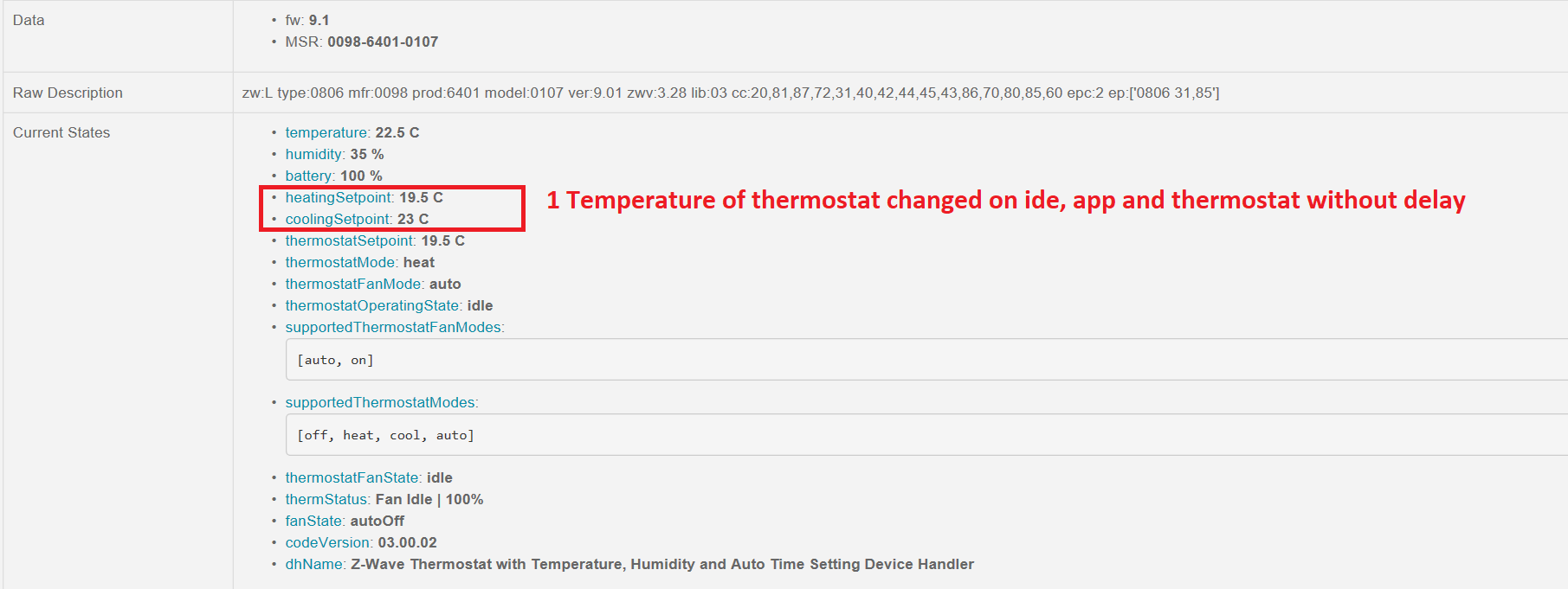

Using your Device Handler I’m able to change the heating temperature with the new full-screen slider for the heating temperature. But for the cooling temperature it isn’t working with the new slider.
It takes very very long, if anyway, to change the temperature. And the slider only can change full degrees, but not 0.5 steps (instead of the up and down arrows). The 1 and 0.5 steps is ok, but do you @RBoy have an idea, why the heating temp is working fine without any delay, but the cooling temp is not working fine?
Thanks for any ideas
Joe
From a device handler point there is no difference between heating and
cooling. It’s likely to do something with ST or your thermostat, if it’s
very slow either your communication is a problem of your thermostat needs
to be reset. Try resetting it (it has a small black button next to the wire
screws to reset it) otherwise try moving your hub closer or adding an
active z wave repeater between the thermostat and hub. You can also try to
reboot your hub and do a z wave repair to improve communication.
I’m assuming you have a CT-xx thermostat and these thermostats do not
support setting temperatures in 0.5 degree increments. They only report in
