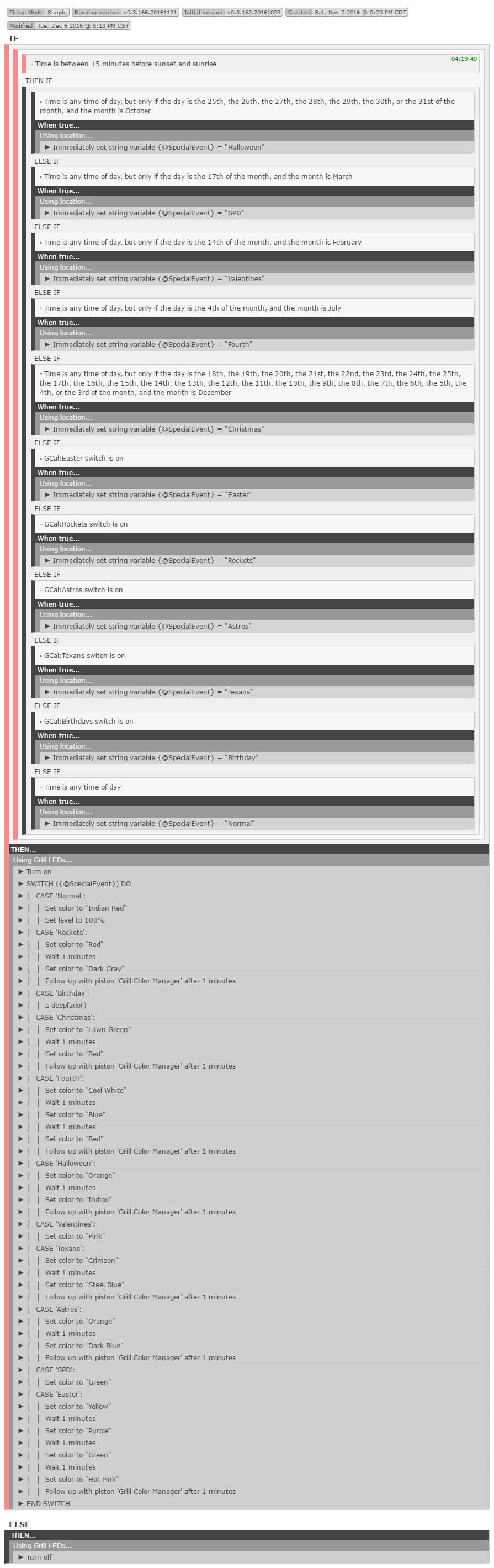

I am having an issue with a possible bug in the following piston that controls a color LED light near my grill. I use it to change colors based on various events. At night right now, it should be changing back and forth between red and green for Christmas.
The variable is getting set correctly and the piston is firing as it should. It is also doing the follow up as I would expect. However, the combination of red and green is not working. The red comes on, but it won’t change to green. I am getting errors in the logs every time it changes to green.
Here is where it gets odd though. I have tried other variations of green (green, forest green, lawn green) and I get the same errors. I have tried replacing the red with green and the green with red. The red still works and the green is still broken. The odd thing to note is that the HSL values for the red as seen in the logs are correct. However, the HSL values that it is trying to use for green (33, 100, 25) are not correct and are not what are listed in the CoRE code (120, 100, 25 for green). I tried changing the color green to blue and it worked perfectly. Red and blue for Christmas just doesn’t fit as well! @ady624 Any ideas? Thanks.

I disabled the LIFX scene integration (I wasn’t using it anyways) and it didn’t help. I recently added more automations, so I moved 2 pistons to another app instance and now it works. I guess I am pushing the boundaries of either the app or the platform.
CoRE uses degrees for Hue. ST (and your DTH) uses percent. CoRE divides the 120 by 3.6 and sends 33. Looks like the DTH has a problem with floats. Can you show me line 722 of your DTH?

Hmmm. I just assumed it was line 722 in CoRE that was throwing the error. I’m using the supplied DTH for the Fibaro RGBW Controller. I am not using something from GitHub. How do I find code for stock DTHs? I haven’t done that before.
Give me a min to check something
Docs say number, they don’t mention integer or float. I think CoRE provides a float number, because 1% is a mighty big chunk of 3.6 degrees which may greatly affect the resulting color. It appears that the Fibaro was designed with integer in mind, or something else is afoot that I am not aware of. Will try to look for the code. Open the IDE, create a new DTH from template and see if the Fibaro DTH is available as a template. Then look for line 722. I am on a mobile phone…
