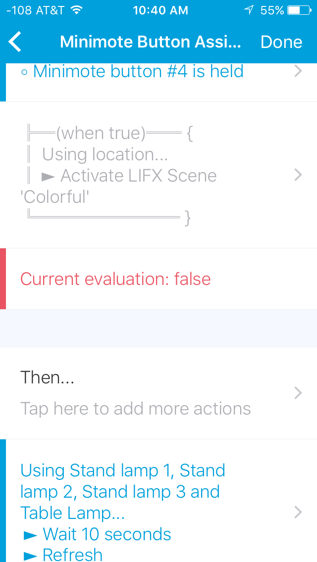

I thought I’d just throw this out there… I’m loving the LIFX scene integration. The only issue with activating a LIFX scene through core is that I have to add to the piston a first wait, then refresh command 10 seconds after activating a scene because the LIFX bulbs will never show as on in the st app until a refresh is done.
I have one minimote in my living room dedicated to activating LIFX scenes. Lovin it. !
