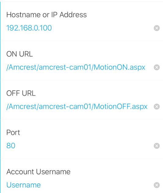

Sorry, I am not a developer. I just know enough to read other people’s code. I never use the full features of the handler in ST. I like Amcrest app for viewing. It was the automation/integration that I would like to have with ST. I ended up having the handler in ST talk to a home server (already have it running 24/7 anyway)and then have the home sever using wget in a batch to send the GET/POST to the camera, triggering whatever control I want turn on/off.

This actually works even I am not within local network. Your code handles the internal calls from ST to the internal web server (not exposed to internet). The server running dotNet framework and response to web query from any internal clients (I can have the web server required basic authentication which also works with your code).
In case anyone interest in the aspx and aspx.vb
Example: turn motion detection on.

Understood the concern of clear/basic authentication. However, the web server is not exposed to the internet.
MobileApp (ST - handler)–>Smarthub (internal)–> Web server (internal IP no port forwarding)–>camera (internal IP no port forwarding)
192.168.0.100 is the web server, unless you can capture the traffic between the ST hub to the web server (both internal/same subnet) the password is not exposed. This is the same as what DTH was doing; clear text password between the ST hub and the camera. My work around was added a server in between. In fact, ST don’t know the password to the camera. it only have the password to the web server site and the web server uses another username/password to access the camera.
