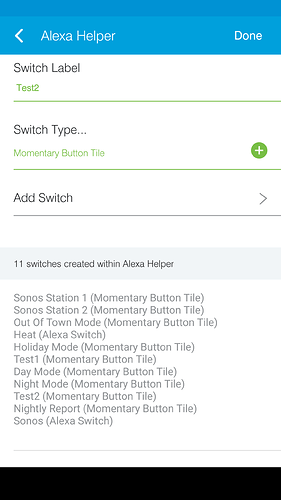

I updated…but am still getting the error trying to add another switch…
How many switches do you have in your account? When you uninstalled the last version did all of the other switches disappear as well? Do you see it being a hard limit of 10 within the app?
I uninstalled and reinstalled and don’t have this issue, so I am curious if you are hitting some sort of hard limit. Can you add additional switches (virtual) in the IDE?

It’s interesting you say 10…I have 10 switches in Alexa helper at the moment. I can still create devices in the IDE no problem…in fact, have been doing that in lieu of since the issue. I am hesitant to uninstall just because I put a lot of time into multiple scenarios already and didn’t want to have to re-create them all.
If I uninstall, I assume I would lose not only the scenarios but the switches created by Alexa helper???
Either way, stuck at 10 and can’t add more.
:frowning:
Tony,
If you delete the scenario the switches will stay. If you delete Alexa Helper, ALL of the switches and apps should disappear. There was a rather big issue with ST on Friday that required a code change, so if you didn’t uninstall after that point and re-install, I recommend doing that. If you did re-install after Friday and got all of the latest code, you should be fine. However, I just tested this and here are my results…
There is nothing in the code that is limiting you to 10 switches. Is there an error when you get to 10? What if you switch the type of switch? Outside of the app, what is the log saying?
Let me know and we can attempt to work through it.
I did update the code, but I didn’t uninstall/reinstall…I guess just updating the code is not enough huh??? bummer…
I will take a look and see what I need to do. Once I do, i’ll check back…might not have time until this evening or tomorrow…
i really appreciate the help!
Before going through the work of uninstalling, look in the logs for any red items when attempting to create the switch and send me those.
