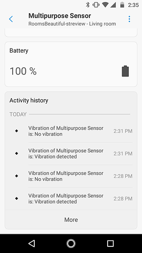

So the new hub-connected developer tools seems to have been released here: https://smartthings.developer.samsung.com/docs/guides/hub/hub-connected-device.html. I’ve followed the instructions and got everything setup. However, many features from my device handler in the old Smartthings app don’t show up in the new one even though the new developer platform still uses the same “Groovy IDE”. How do I implement the features as shown in the screenshot below in the new smartthings app?
I used the same DTH for the new Smartthings app since the documentation specifies to use the same old “Groovy IDE”. But it ends up looking like this. It doesn’t include everything.
Specifically, in regards to the battery, I’ve already included capability "Battery" in my DTH. However, it doesn’t show up at all like the Smartthings Multipurpose sensor DTH. What’s the correct code to implement this battery tile?

The documentation hasn’t been clear on this. As I understand it, the tiles in the groovy ide do nothing in the new app. The new app is controlled by the plugin, which is somehow linked to the VID in the DTH metadata. Your best bet is to reach out through the developer relations channels of the new dev portal to try and get some clarity.
Shoot an email over to build@smartthings.com with your questions. But for your items to show up in the new app they must be specified in the ui metadata and they must be capability based, as in not a custom attribute on the device.
