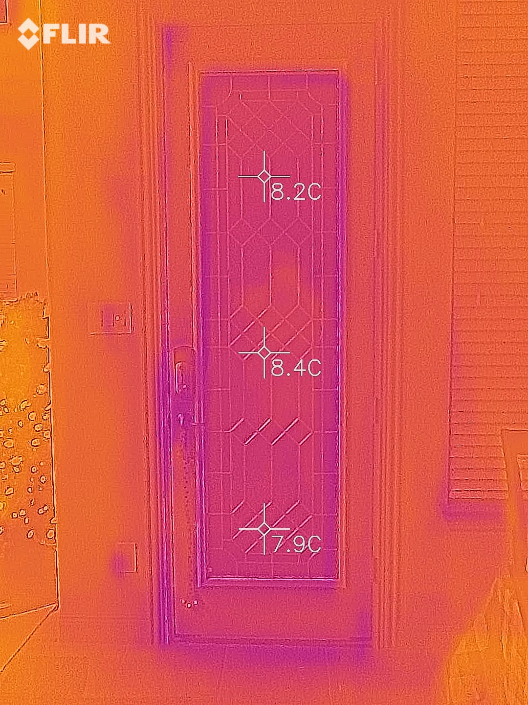

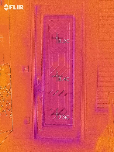

These were taken in December 2018:
Shows cold air leaking in under and around the patio door
Window is not that efficient at keeping the cold out… a similar picture to this one lead me to find that the window was not properly shut and the locking mechanism was pushing the windows apart causing a draft of cold air. The draft was there for quite a long time until I pulled out my Flir and found it. Just running my hand over the leak would have detected it as well but who knew it was even there, all I knew is that the room was freezing and hard to warm up.

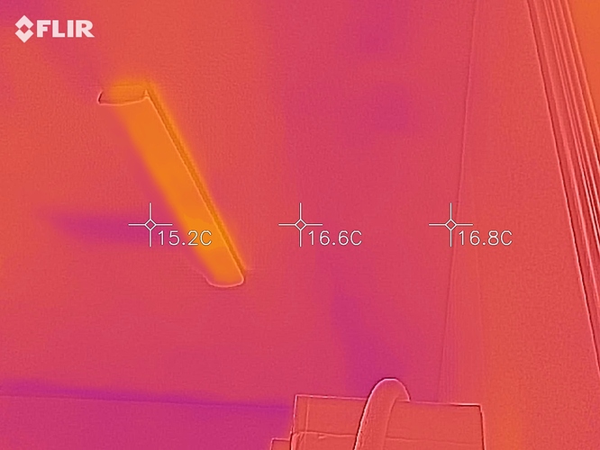

One of my return vents downstairs. This one is inside the shared attic of the master suite so exposed to the outside cold however the image is deceiving in this case… the blueish area is that color due to the hot light and Unifi AP being in the field of view. Either way, you can see traces of poor insulation around the return
