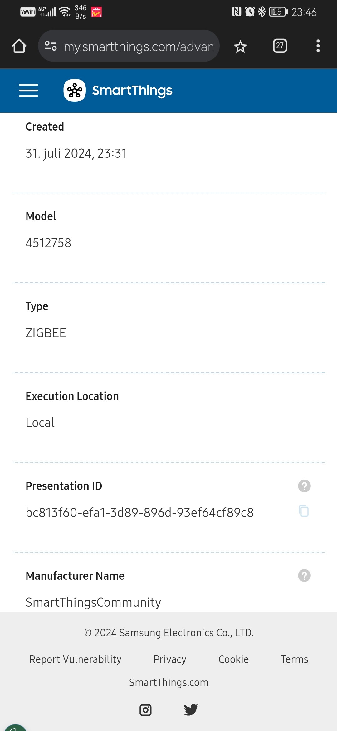

Some more from a different thing:
Details for device βGeneric Switch Power Energy 1β
Key | Value |
Name | switch-power-energy-plug |
Mfg Name | SmartThingsCommunity |
Mfg Code | Namron AS |
Model | 4512758 |
ocf Type | undefined |
Category | Other |
Room | mellomgang |
Presentation ID | bc813f60-efa1-3d89-896d-93ef64cf89c8 |
Type | ZIGBEE |
Parent ID | 0a85d1bd-8d9a-4e41-9ba5-ef85a276d5e9 |
Parent Name | SmartThings Hub |
Driver ID | 8bf71a5d-677b-4391-93c2-e76471f3d7eb |
Driver Name | Zigbee Thing |
EUI | 70AC08FFFE6D079D |
Network ID | 9D35 |
Provisioning State | PROVISIONED |
Local Execution | yes |

Added to this driver TEST version according to the Namron manual as a thermostat for HEAT and COOL, even if you use it only for HEAT
I have doubts that the manufacturer fingerprint you posted βNamron ASβ is correct, since in all Namron thermostats in the driver the manufacturer is βNAMRON ASβ. In the advanced web user capture you posted only the Model is seen and not the manufacturer.
Only the basic functions of the thermostat have been added, the programming and adjustments are made in the physical thermostat.

I will try as soon as I come home. If this works i will PayPal you a 6 pack of beer to enjoy. Even if it donβt workβ:grin:
If it does not pair with the driver I need you to confirm the manufacturer on the advanced users website
