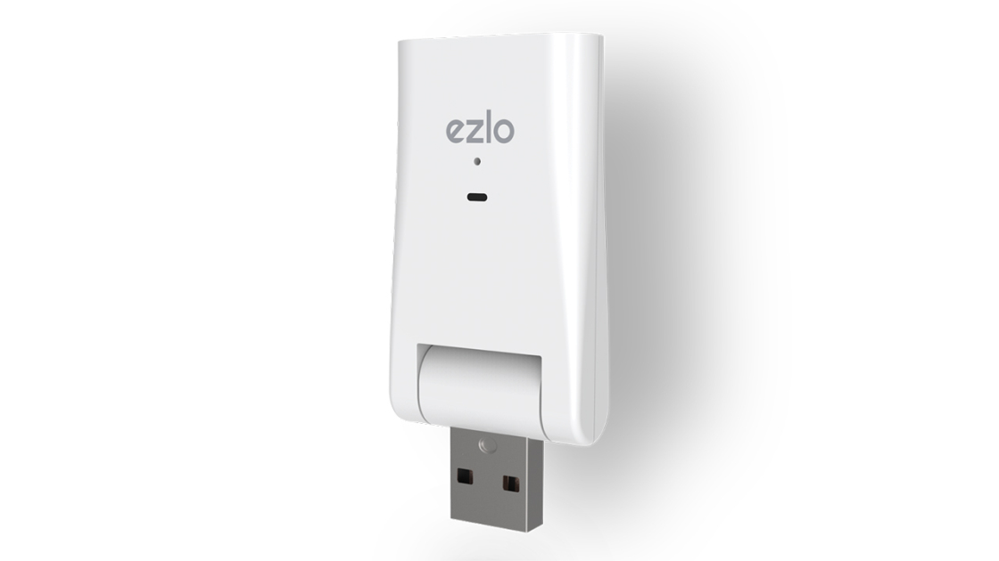

BTW, I know you already bought and installed some zwave switches without realizing that they needed a hub.
If you just want to buy an inexpensive simple Z wave hub so you can play around with those, have a phone app for them, and maybe start learning what’s most important to you in home automation, the EzLo Atom Gen 2 should cost less than $40, is available in multiple countries, has a simple rules engine and app, it works with the popular voice assistants if you do decide to add one, and it’s very easy to set up. There are significant limitations: it will only work with Zwave devices, and only up to 30 of those. But it will let you get started with the devices you already have and if you run into frustrations like feeling that you want to add other devices of other protocols or you do want more complex rule building support, well, that will help you focus your own research. So it can be a good pilot program for somebody in your situation.
Here’s an independent review:
And here’s a reliable retailer
You can also buy it at Amazon from third parties, but it typically costs about twice as much there.
If you do get it and have any questions, you can ask in the EzLo forums or, again, at Reddit. ![]()
Or you may decide you don’t want Z wave at all, and return the switches you just installed in favor of some other ecosystem. Choice is good. ![]()
Note that because of the limitations, I do not recommend the Ezlo Atom for someone starting from scratch. But for someone who just has a few Z wave devices and their old hub broke or they moved into a house where there were Z wave switches but no hub, this is a decent solution either just for that limited use case or while you are figuring out what else you want to do long-term. It’s also a decent substitute for a Nexia hub for most people, which had similar limitations but now has a monthly subscription fee. Or for someone who just needed to automate a few devices in an outbuilding. And at least it will bring the devices into Alexa and a mobile app.
So I just thought it might be something that would be a possibility for your situation. I wouldn’t expect you to stay with it long-term, but at the price, it might be good for a pilot phase.
