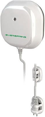

Not entirely waterproof, but the Everspring ST812 Flood detector is rated at IP44 liquid ingress protection (water splashing). As with the Dome sensor, you would want to ensure the main unit is somewhat protected from the elements. It’s a solid sensor and with a 10 ft cord, uses 3 standard AA batteries which can last quite a long time.
Only issue with the Everspring is it is not Zwave Plus and it doesn’t have as strong of a signal. I had the Lowes Utilitech version in my crawl space and couldn’t keep it connected. I replaced it with the Dome, which is Zwave Plus and it has been rock solid.
