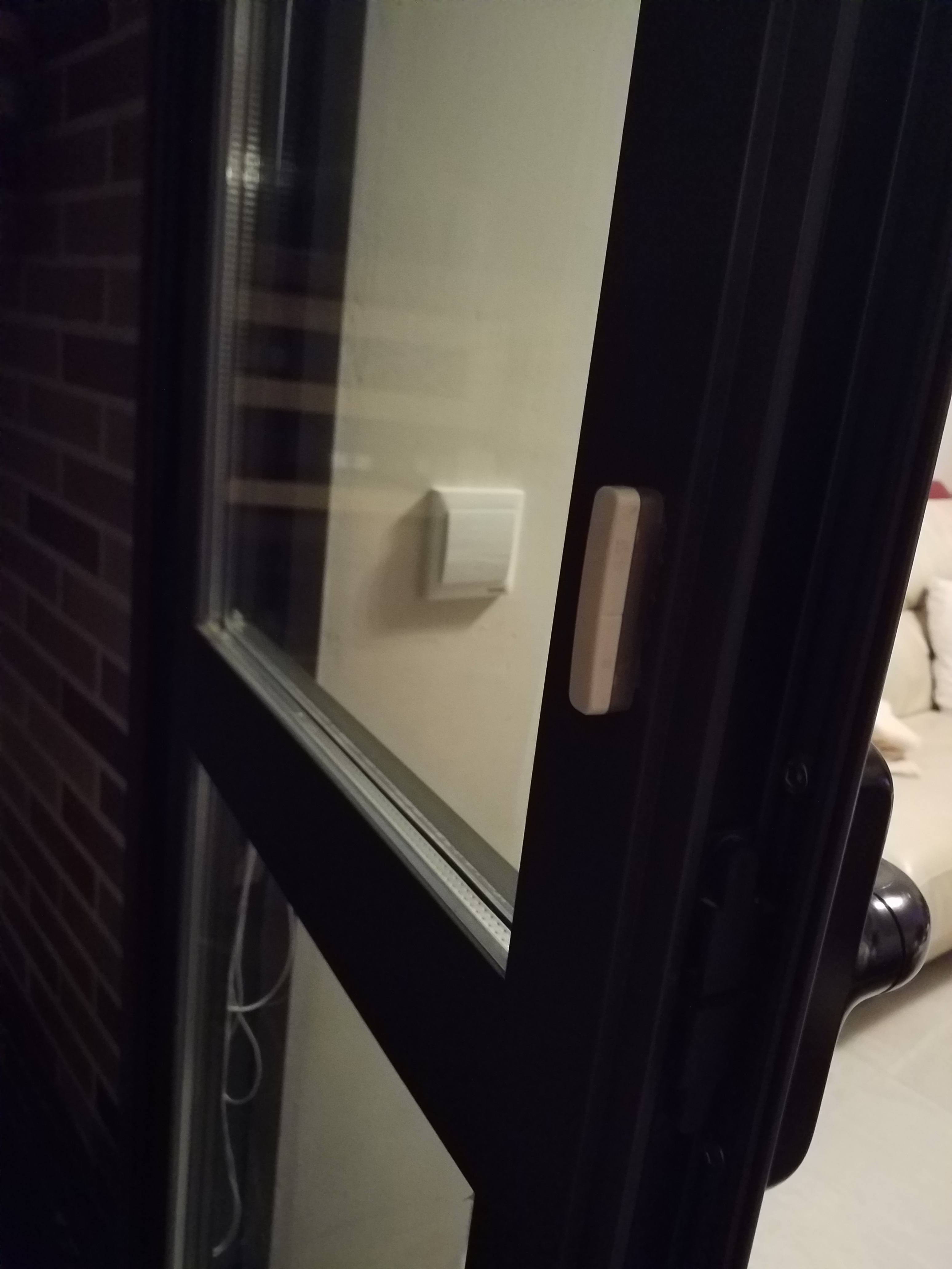

I got this device
In theory an open/ close sensor, but it’s only identified as a motion sensor…
I think (can’t be sure anymore with all the dh changes) it’s the Philio PSP01-1 Sensor… got the dh from here, the community, somewhere.
Ideas?

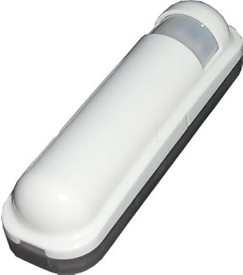

Found your problem…that isn’t an open/close sensor. The listing for that model number on Amazon lists it as:
PHILIO PSP 01 (1)PIR, (2)temperature, (3)illumination 3 in 1 sensor
@Ryan780 is correct.
I was going through DTH’s on here for it and none show anything about open/close. It is just motion, temp, illumination.
