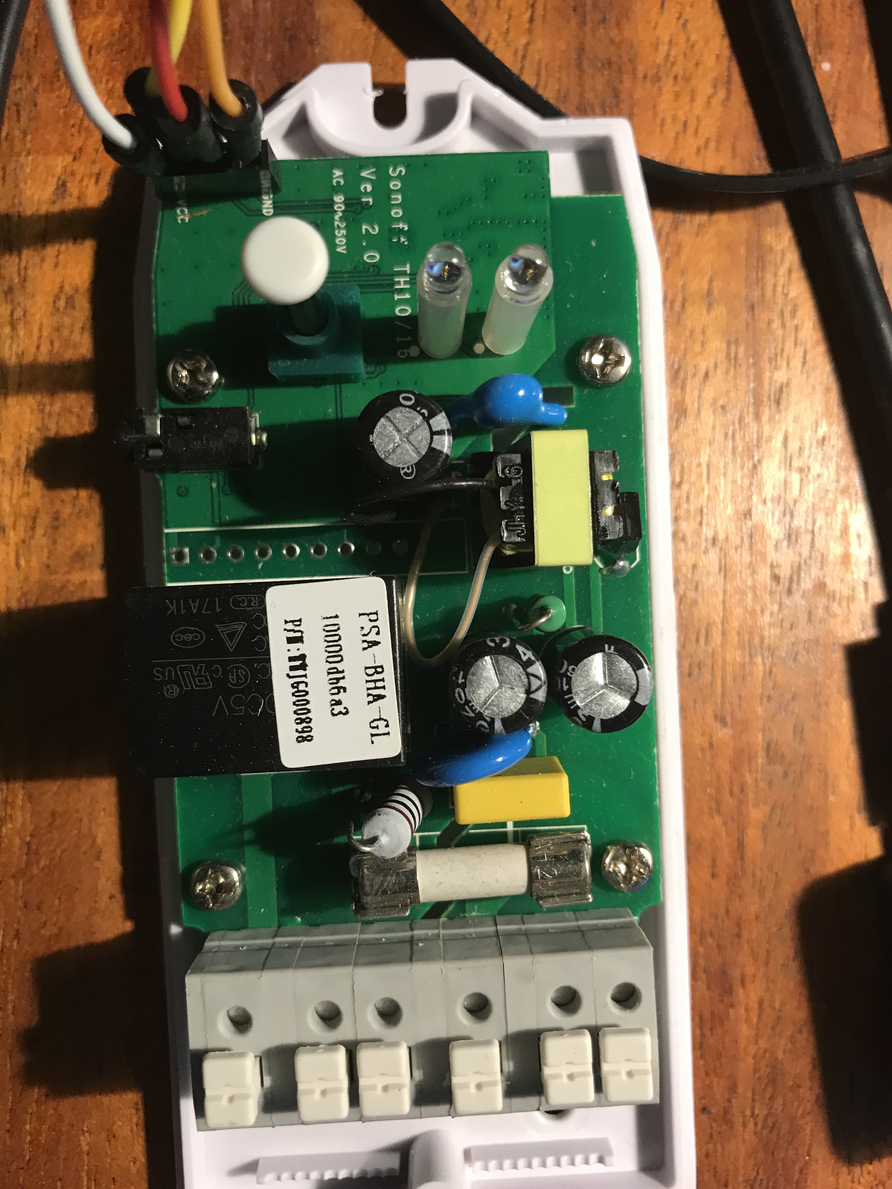

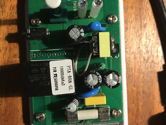

Where are these other switches of which you speak? Mine has only one (obvious) pushbutton.
Sorry, I thought you were having problems with the sonoff touch. Your photo appears to be a TH10 or TH16. To flash that is the same as a basic sonoff except using SonoffTH.ino.generic.bin. I have done 2 of those without any problem. Please note, NEVER plug or unplug the probe from the sonoff while it is powered up.
