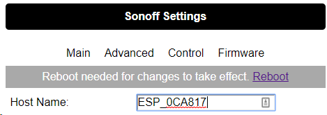

I’ve added the ability to set a “hostname”. This is the hostname that is presented to your dhcp server when requesting a lease. Depending on your router, you may be able to access the device via its hostname instead of ip address.
I also added a banner that appears if you change a setting that requires a reboot.
There is a new boot up state called “Inverse Previous State”. So if the switch is on when it is rebooted the boot state will be off. If it is off, the boot state will be on.
Ability to set the debounce for the physical button or attached switch (in ms).
Device voltage selection for Sonoff POW.
