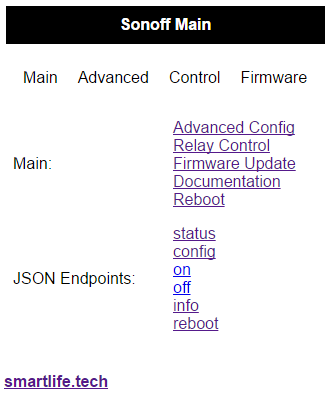

Can you elaborate on how you access the config menu for the device? I can’t get the auto off to work either.
