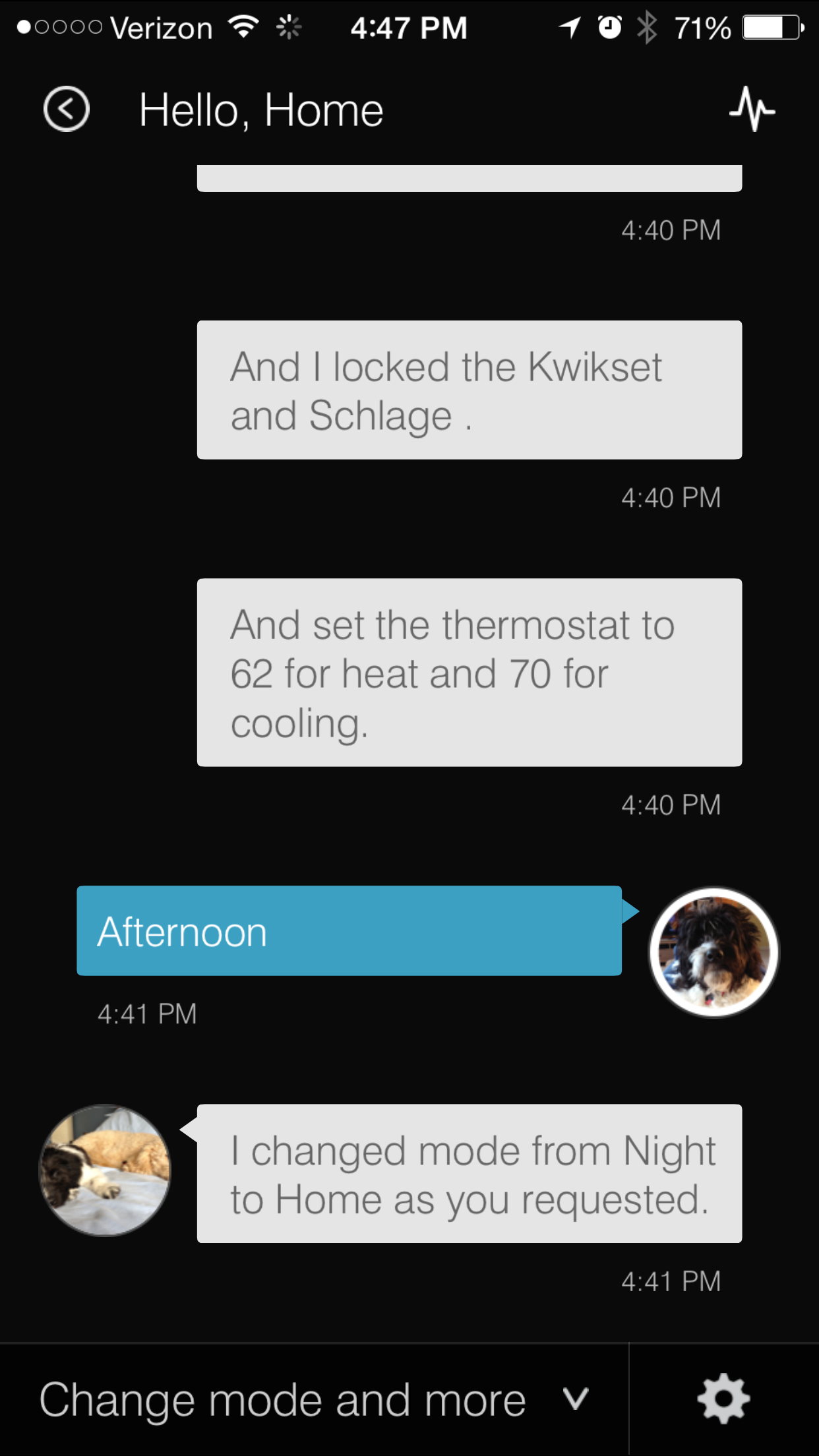

I just hit the H,H action “Good Night”. H,H showed turning on a switch, locking doors, changing thermostat set point. Here’s a photo for what I got from H,H when I triggered “Good Night!” -

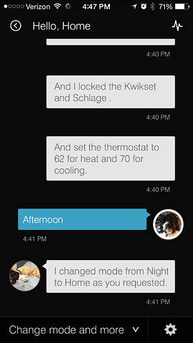

I then triggered another action - Afternoon - to get back to Home mode, and set thermostat back to daytime set point. Live Logging showed this -
4:41:18 PM EST: trace Smart Alarm disarmed
4:41:13 PM EST: trace Deleting all scheduled jobs for InstalledSmartApp:
And H,H showed this -
I’ve got to think this is an ST issue with the lag in actions being performed. All that action did was change the mode, no thermostat set point change.
As you can see in both photos - H,H never mentions arming or disarming Smart Alarm, even though the Smart Alarm shows the status as armed Stay.
