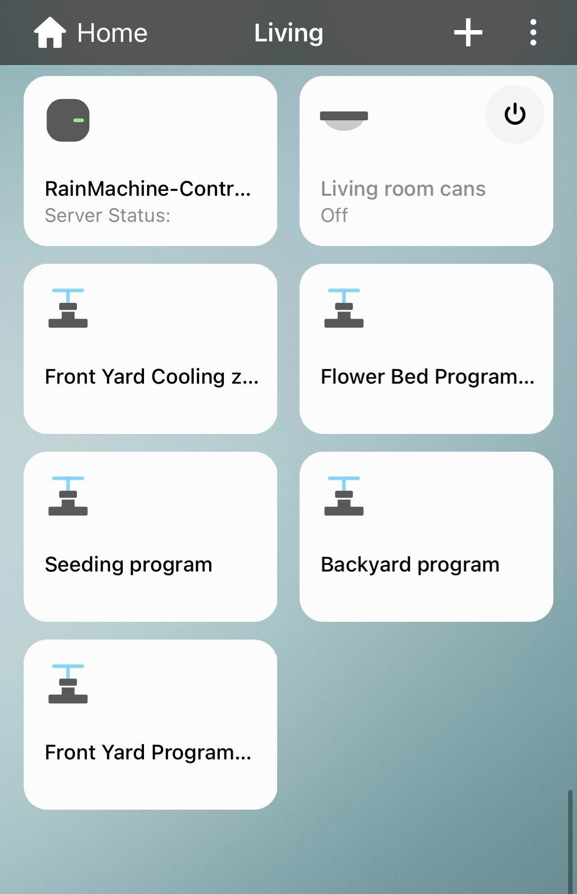

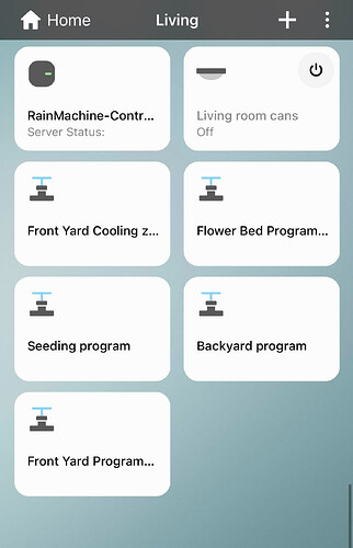

@brbeaird, I got it working! It turned out I needed to decrease the number of programs. When it was set to 30, it was timing out and failing. Setting to exactly 7 (the number of programs I have) worked like a charm. I finally started using the IDE log and reading through the code, which tipped me off to try a few more things. FYI, for anyone with a similar problem (which may only apply to the Mini-8 for all I know).
And, for those watching at home, I went an extra step today and bridged it to HomeKit with Homebridge, since the Mini-8 isn’t HomeKit compatible all by itself. :slight_smile:
