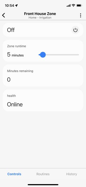

hmm, so 2 out of my 5 zones dont have the option to adjust the duration to water.
they display only on or off and the health. strange.
nvm… i turned the zone on, and then off, then refreshed, and the time option appeared! beautiful work!
edit #3 … strange, i set the time to 30min and it still seems to only work for a couple min and shut off. does this take into account if the zone 1 is a master valve?
edit#4… so i set my zone 1 to 30 min aswell… same thing. i set both zone 1 and my front sprinkler zone to 30 min and still, it will only work for 1 minute.
I see aswell under “minutes remaining” it will say 1 minute when i turn on the zone even though i have 30 selected on the bar.
