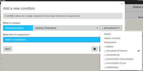

Finaly the Aqara temp sensor to work. One worked right out of the box with the custom handler from bspranger. The second sensor took a bit more doing as it attached it self to the samsung smartthings outlet. Once I got it to connect directly to the hub it seems to be stable.
Even got pressure to “work” with action tiles. Added pressure atribute to bsrpangers code. This way I can get webcore to read the temperature. And send it to a virtual device in smarthings which in turn can be read by action tiles. Unfortunatly it has to be read as something else, I chose temperature as it just ads a little degree sign after the pressure. Sent a request to smartthings to add pressure as a capability, while being very friendly stating he forwarded my request to the design team Im not too hopefull this will be added any time soon.

Atmospheric Pressure Measurement is already a capability, but not everything supports it yet. I use it in my stripped down, revamped, new app only, version of the bspranger driver.
https://github.com/orangebucket/Anidea-for-SmartThings/blob/master/devicetypes/orangebucket/anidea-for-aqara-temperature.src/anidea-for-aqara-temperature.groovy?ts=4
And yes that driver has some friends but only tested on the sensors I have.
I agree, i started with smartthings this year so i was trying to keep things in the new app as the old one will shut down at some time. But more and more i keep falling back to the old one :confused:
Aha, I couldnt find that in the list of capabilities in the documentation. I will have a go and see if I can get it to work. Would be awesome to have it straight like that.
It certainly appears in the Device Details but to most other things it is a custom attribute at the moment. I simply can’t remember where I found it listed though.
Doesn’t seem like it pops up in action tiles or webcore for the aqara temp sensor device. Oh well I guess I will just have to stick to my workaround.
Attributes will always work, the problem is having it as a true capability so its availalbe throughout the system.
It is certainly a true capability, albeit a ‘proposed’ one. I tracked down the details from the SmartThings API:

I actually use it with mbar as the unit as that is what the Aqara device uses, and it doesn’t seem to mind. As it only seems to like displaying integers in the app, kPa seems like rather a crude measurement (for reference, 1 kPa == 10 mbar == 7.5 mmHg). So I think the capability needs some refinement.
Have you tried removing the device from webCoRE and authorising it again? Only …
Clipboard01
hPa would be the prefered unit, basicaly the same as mbar. Ill have a look at this when my brain can handle it. I think I may have made a mistake implementing it.
From your last picture it does look like atmospheric pressure commes up as an attribute in webcore. From my understanding it should be without the little house infront of it to be a capability.
Action tiles does not support attributes so it probably wont work for me.
