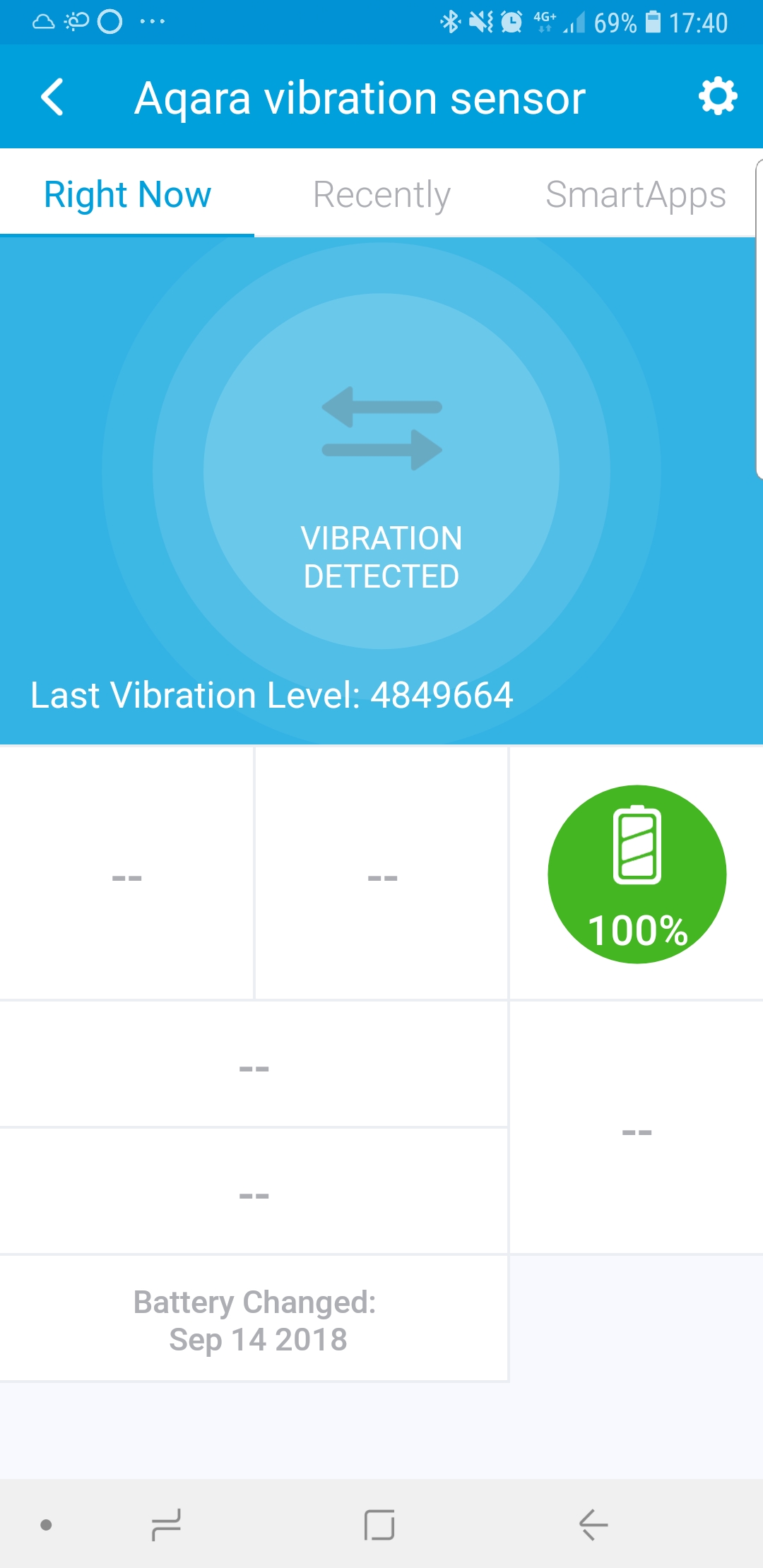

The 0505 attribute does not seem to be a level, it is reported at some interval. Judging by the fact that it is referred to as a bed sensor I think it’s just a timer with time elapsed since last vibration. In any case it reports a large value when the sensor is not moving, so the value needs to be something in seconds I guess.
ca98cab-69db-4d26-9295-807a7a299c5a 6:03:43 PM: debug Aqara vibration sensor: Creating event [name:vibrationLevel, value:5177344, descriptionText:Aqara vibration sensor: Vibration level reported at 5177344]
8ca98cab-69db-4d26-9295-807a7a299c5a 6:03:43 PM: info Aqara vibration sensor: Vibration level reported at 5177344
8ca98cab-69db-4d26-9295-807a7a299c5a 6:03:43 PM: debug Aqara vibration sensor: Parsing ‘read attr - raw: C92E0101010E05052300004F00, dni: C92E, endpoint: 01, cluster: 0101, size: 0E, attrId: 0505, encoding: 23, value: 004f0000’
I’ve seen that 004f0000 value a lot over the last days and only the first 4 digits change, the last 4 stay at zero. I’m not an expert at value encoding so I need some expertise there :slight_smile:
Aside from the 1,2 and 3 value for the 0055 attribute it also reports a larger value which now causes an error:
error java.lang.NumberFormatException: For input string: “00522105030002” @line 205 (parseReadAttrMessage)

This gives somewhat meaningful values:
		else if (attrId == "0508") {
			//def x = (short)Integer.parseInt(value[9..11],2)
			//def y = (short)Integer.parseInt(value[5..7],2)
			//def z = (short)Integer.parseInt(value[1..3],2)
            def z = zigbee.convertHexToInt(value.substring(0,3))
            def y = zigbee.convertHexToInt(value.substring(4,7))
		def x = zigbee.convertHexToInt(value.substring(8,11))
I still hold the theory that this is raw output of number of vibration samples data from the on-board accelerometer. I just forgot to only convert the first 4 bytes (16-bits) of data. I have fixed that in the DTH code on GitHub. So now the value of 004f should give an integer value of 79. Even when the sensor is stationary, it’s totally possible that the accelerometer is picking up some slight movements. A real test of my theory would be to really shake the sensor hard and see if the attribute 0505 output caps at an integer equivalent of 512.
Ah yes, it was mentioned in the information I’ve read that attribute 0055 reports can actually include two attribute reports. So in your example the value of 00522105030002 can be parsed going backward like this:
0002 = the actual value for attr 0055, which corresponds to a tilt detection
0503 = a secondary attr report for attr 0503, corresponding to tilt angle change value
21 = encoding
0052 = value for attr 0503, corresponding to a tilt angle change of 82 degrees
I will fix my code to handle this correctly.

[BETA UPDATE] Xiaomi Aqara Vibration Sensor (Model DJR11LM) v0.6b
Updated code can be grabbed for testing from here.
Changes
  • Added preference setting to set the sensor’s accelerometer sensitivity level (untested) which will also display an event, live logging entry, and update a new mobile app tile displaying the current sensitivity level. Note that the sensitivity level will be unknown and displayed as blank until it is set in the preference settings for the first time. I plan to see if there’s a way to read in the sensitivity level when pairing the device so that it is known and displays from the start.
  • Fixed the handling of tilt event messages, which should be correctly recognized now
  • Fixed the handling of tilt angle change value reports, and there is a new function parseTiltAngle() which could be expanded to link to a SmartThings capability (such as button 02 - pushed) to notify the user or take actions when the change in tilt is greater than a user-set threshold.
  • Changed the way “Vibration level” values are converted to an integer, with a max possible value of 65535, though I expect only values up to 512 will be seen. Any reports of observed values, when they occur, and how often would be greatly appreciated.
  • Other minor code refinements, organization, and clean up
