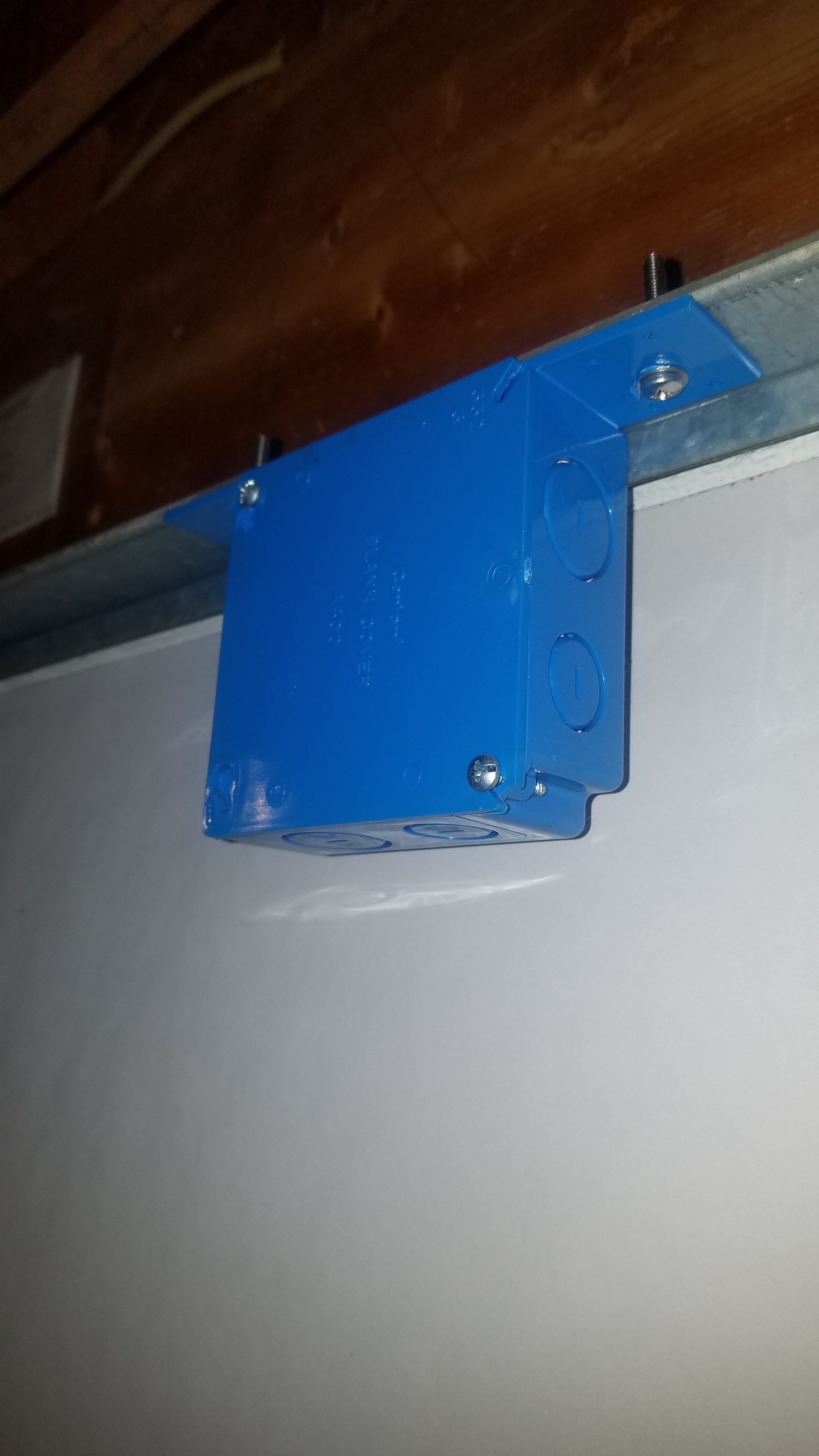

Being from the cold north, the small expensive watch type batteries in most sensors simply don’t hold up in the weather. The best solution I have found was to convert the TILTZWAVE2-ECO over to two regular AA batteries. I use this on my mailbox sensor too.
The TILTZWAVE2-ECO can still be pickup for $18-$25 on Ebay. For about $2 more, you can get an electrical box and battery holder to complete the mod, this will upgrade your power capacity x 10. I haven’t had batt issues since install over 2 years now. Plus AA are very cheap.
This allows an easy mount at the top of the door, staying away from all the door hinging and cables, plus triggers as soon as the door goes up and ensures close is not indicated till full down.
