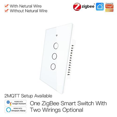

Hello. I have the same device but mine is the US version.
The device handlers doesn’t seem to work for me. There’s no backlight on the switch, and when I turn on one of the gangs, it turns on the others (or sometimes just another gang).

Hi Yakov. I’m new to Smartthings and am not a developer or a coder, so hopefully I correctly gathered the data below.
  1. I purchased the switch elsewhere, but it should be identical as this one:
