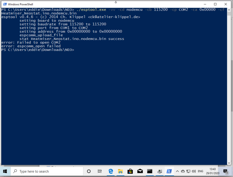

I have tried to program the nodeMCU, but I am getting the below error. Ive tripled checked its on the right COM port- Any ideas?

Yikes, take a step back! None of this should be needed, and certainly not flashing it. You should just need to find the device IP again, as deleting from the router shouldn’t stop it trying to connect to the WiFi network.
If you have a Windows PC then do you see it appearing inside Windows device manager? Thats the easiest way to find it, as it should send some information that helps windows find it.

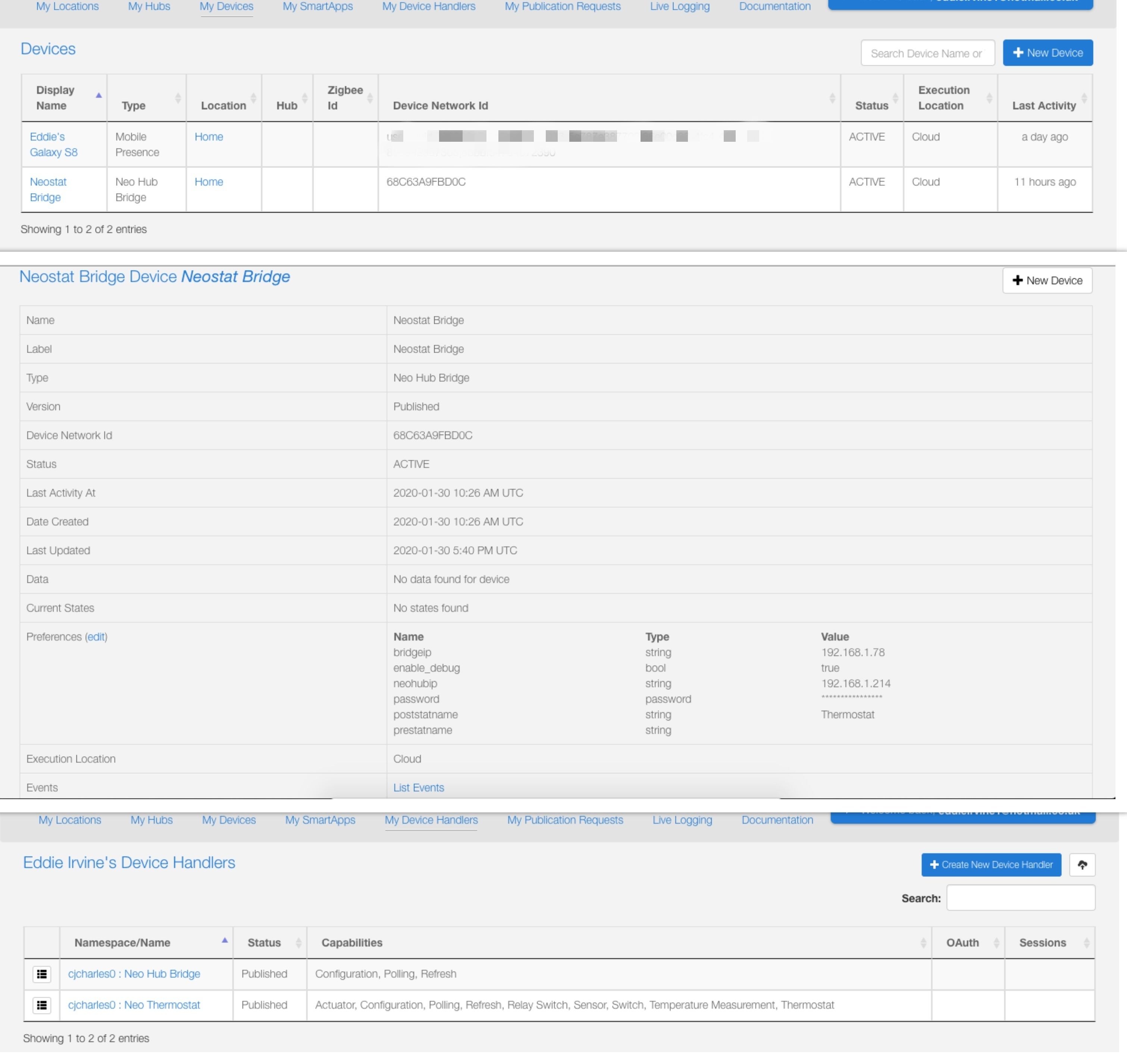

Can you post a screenshot of the device in the ST web IDE (account.smartthings.com)? I think you might have added the device in the wrong way or place - given I think that error is related to ST not finding your hub.
Hopefully this will make some sense to you :slight_smile:
I need the bit under events, just where you’ve cropped it sadly :stuck_out_tongue: But also just making sure you haven’t added any passwords? Make sure they’re blank in the nodemcu and also in the device handler on the phone.
