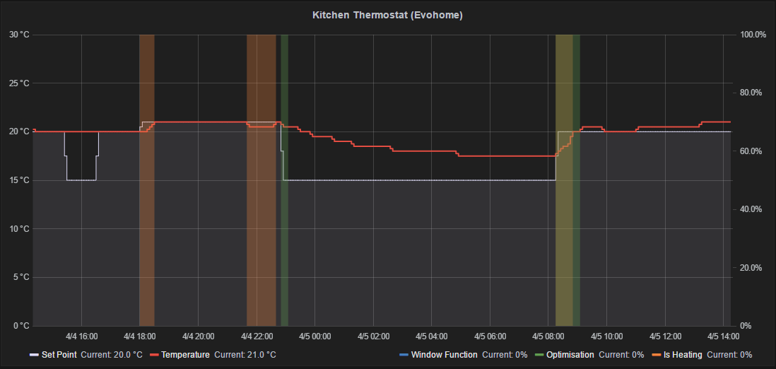

I’m quite pleased with it all now though. In conjunction with my Evohome (Connect) SmartApp I’m getting some great graphs of my home heating behaviour and enery usage. Here’s a quick example:
[Updated with a better chart showing periods of heating and optimisation]
