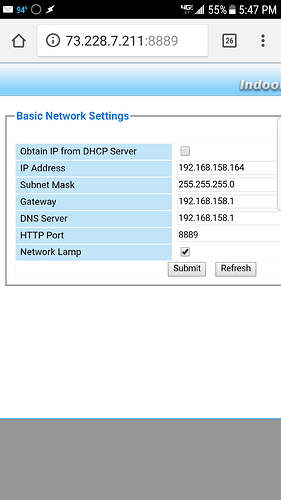

  2. Camera itself, here’s a screenshot (your model may vary)

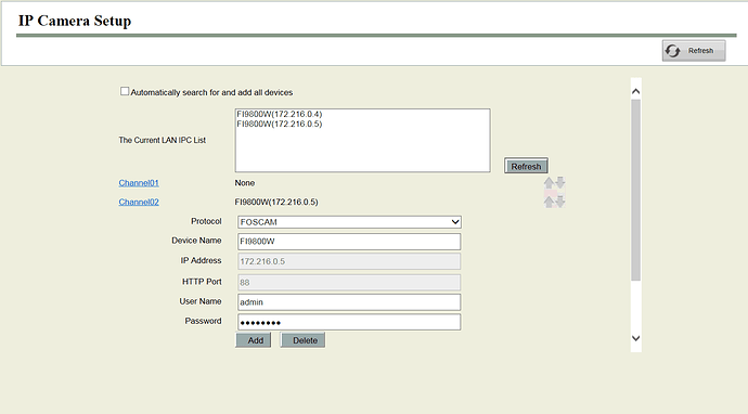

Okay so I’m in my Foscam software and I’m under settings. I’m looking at IP camera setup and the option to alter my IP is greyed out as seen below.

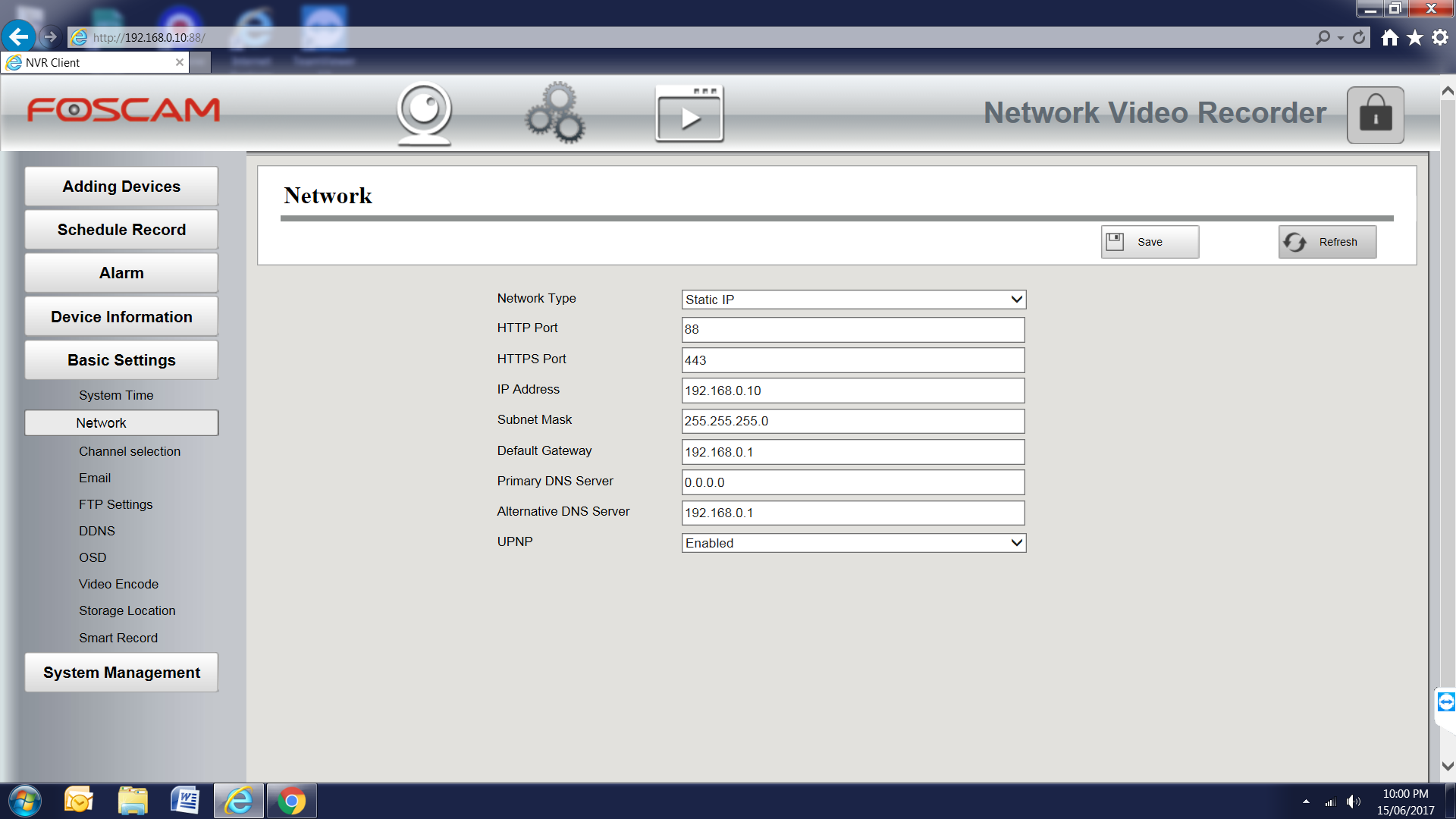

I’ve looked through the basic settings under network and this is what I can alter

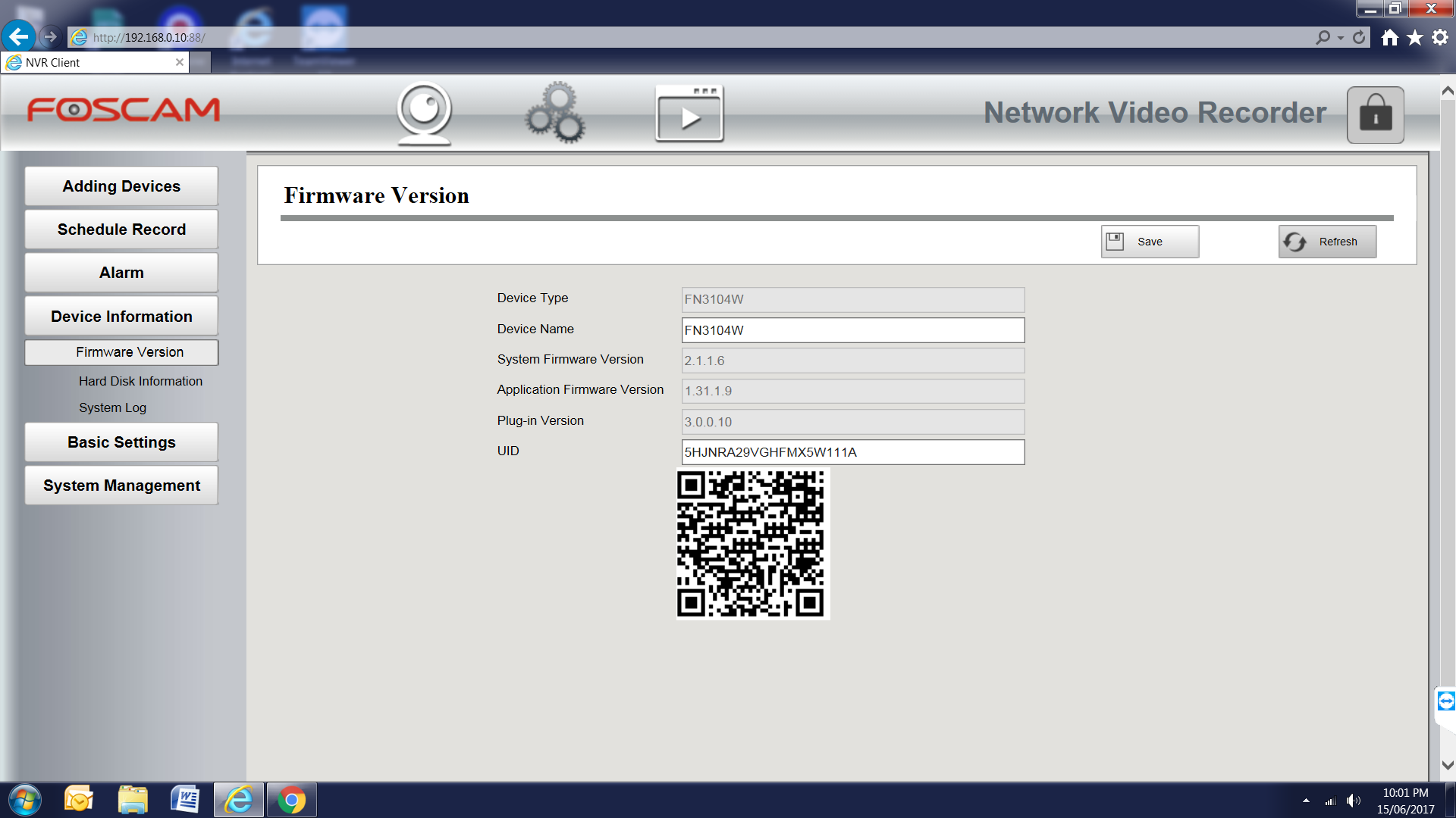

Any ideas what I’m doing wrong? I’ve tried to update the firmware. I am running these settings:

I never use the foscam setup tool, always do it manually. You second screen appears to be where you set your IP address for your camera. Don’t know what you’re using the first screen tool for. In any case it looks like the first screen has a whole different IP subnet from the second screen.
This is classic networking stuff, I would recommend get hold of a friend/professional who’s familiar with networking setup and have him come and setup your networking. I don’t see any good reason to have two LAN’s within a single house.
I know what the problem is but I can’t find where to change the subnet. My network does not see the cameras as they’re on a separate subnet. If I change my network to the same subnet to see them would that allow me to assign them a new IP? I tried to do it by assigning a new IP to the Mac address but to no avail.
Where did you get the 172.216.0.5 & 4 addresses from? Those belong to Verizon and have real routes to them.
