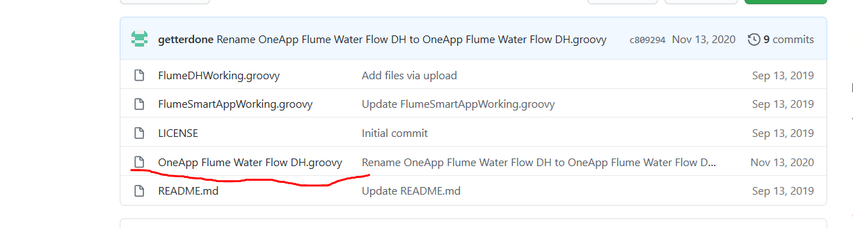

Copy paste the code above from OneApp Flume Water Flow DH.groovy file then hit Create button.

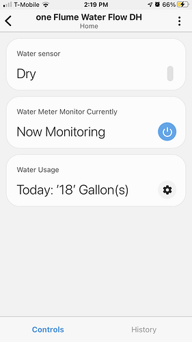

You’ll see this in OneApp:

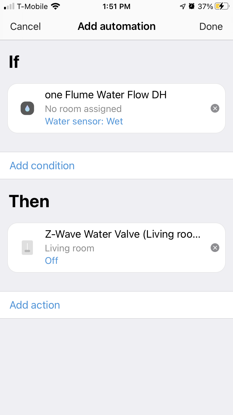

This looks great! I had the previous version of Flume (they have a new version out now) and got rid of it because I wasn’t able to integrate it with ST. I just happened to bump into this thread and I’m glad I did. Just so I understand this, would there be a way for WebCoRE to shut off a water valve (already have that installed and connected to ST) in case it detects a heavy flow leak (or maybe even a slow leak?) Will your implementation work with their newest Flume version? Thanks
The sensor is visible now within the SmartThings app
so ill be surprised if flume wet/dry sensor is not visible in webcore, ill get you a screenshot to confirm.

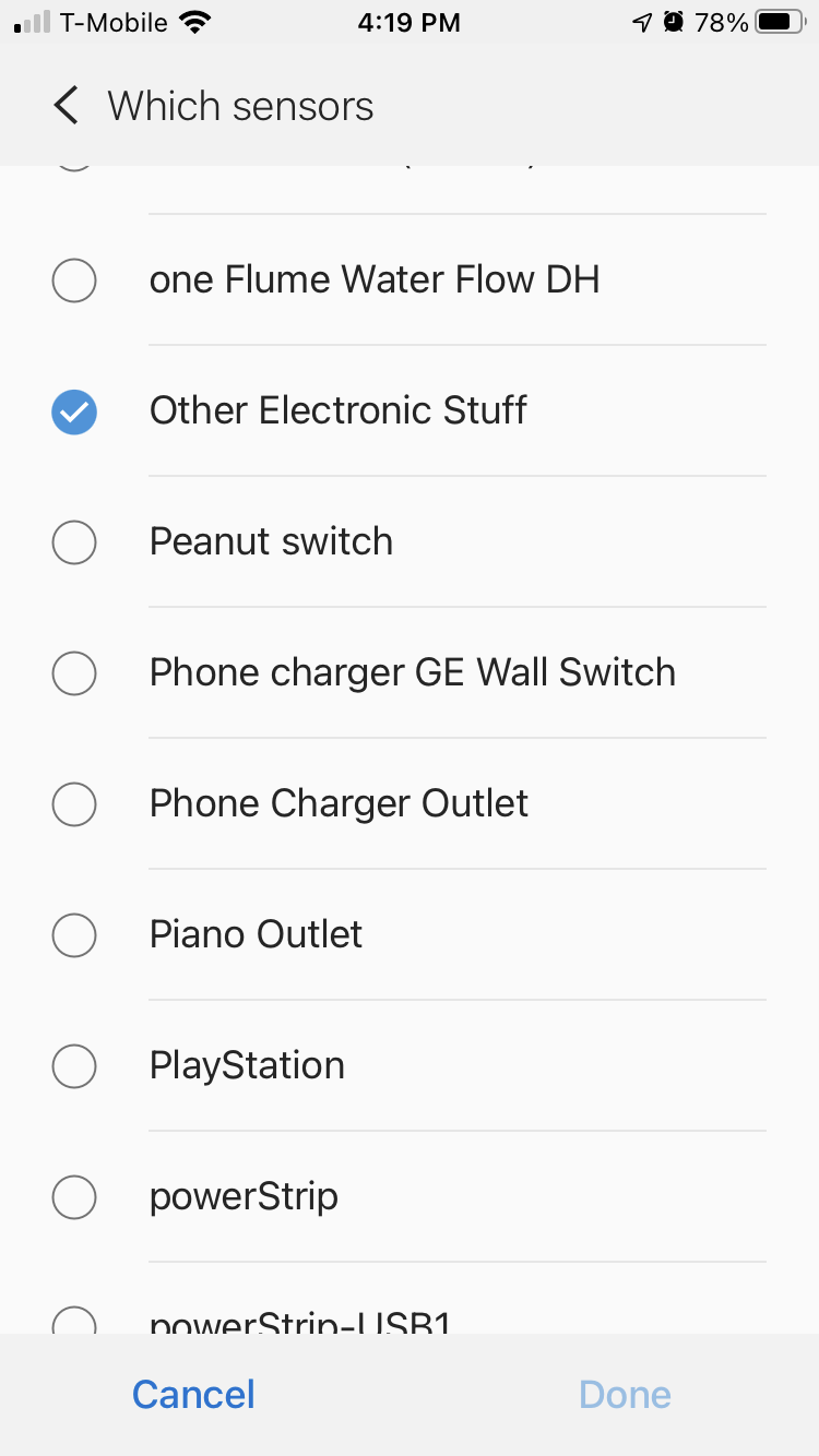

Here’s the sensor for webcore pistons

The newer OneApp DH https://github.com/getterdone/FlumeWaterMeter/blob/master/OneApp%20Flume%20Water%20Flow%20DH.groovy seems to be working atleast from the logs (apart from one error about the old FlumeDH).
