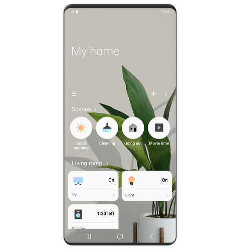

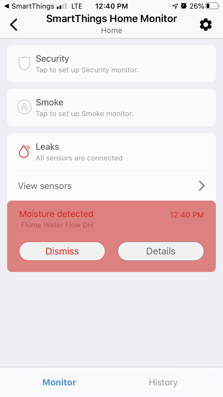

Do you mind taking a screenshot of new SmartThings home screen to see where the alert is displaying at? Im still using classic version so im not familiar with new ui.

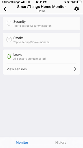

Did you have Home monitor app installed in new SmartThings app prior to deleting alert in Flume app?

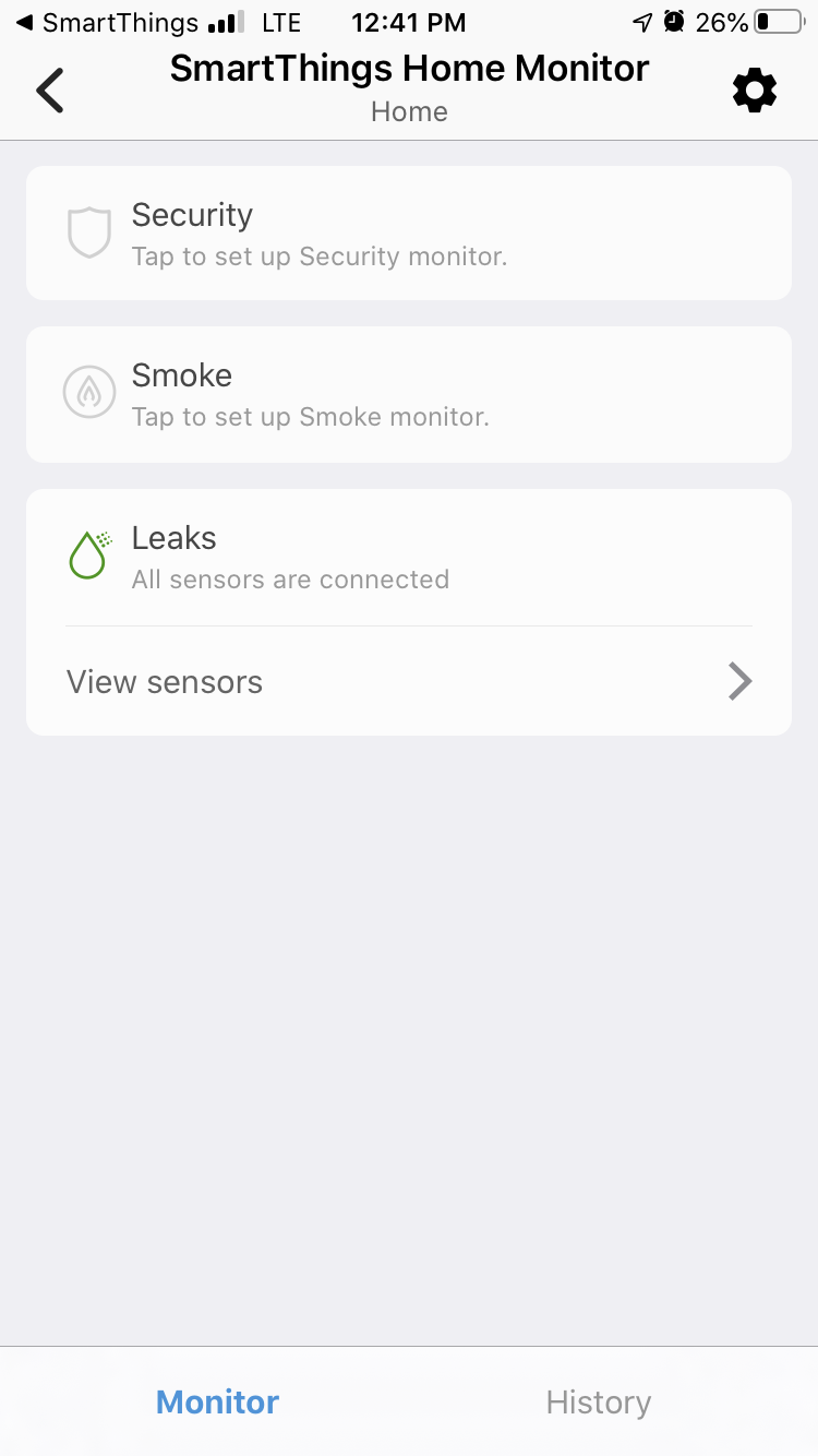

I just installed SHM and now my home screen looks like this:
Here it is … it is actually a friend of mine who is new to smartthings and is using the new app. I too use the classic and mine is fine (BTW, thanks a TON for doing this work!).

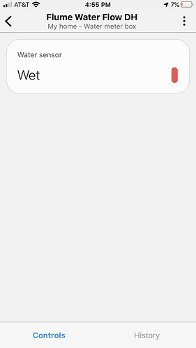

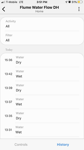

I did some debugging and the water sensor is working on new app too as designed.
Some clarification: Dismissing the wet alerts sent by Smarthome home monitor won’t reset the Flume sensor from wet condition to dry condition* .
*I think there maybe some miscommunication on my part on the how the Flume sensor resets to dry on the SmartThings new/classic app.
*The way the sensor currently gets switch to wet is by having ‘slow leak’ alert message initiated by Flume app. In order for the wet condition to switch to dry the user would have to delete the wet alert message/notifications in the Flume app. Once the message gets deleted give it a minute or two and the Flume sensor would then switch to dry.
If you rather not wait you can also do a manual refresh** in the new app by dragging the sensor down midway of the screen and letting go (I just found out today by accident on this refresh drag method) and the sensor will be reset to dry remember the alert message/notification needs to be deleted first on the Flume app

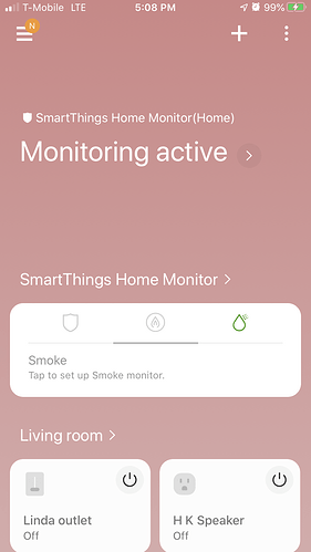

This may be a basic question, but I can’t seem to get the Flume info to display on the main page of the new Smartthings app. I’ve added the device handler, added the API keys, enabled smart auth, and added the SmartApp. Nothing seems to show up on the main smartthings page though. Any thoughts? This dashboard is the page I’m referring to.
It wont work in the new app until the DTH is updated.
Mine shows OK, unless I’m misunderstanding the question.
It shows OK, but if you click into it, there aren’t any attributes that show aside from wet / dry.
Ah. Right. I agree.

Yea, mine is stuck on WET in the new app! =). How do I turn off the notifications for it in the meantime?
Did you have a Leak notification on the Flume App?
If you did try to delete the Leak Alert/Notification: Settings>Notifications>Delete All or find the specific Leak Alert and delete it. Then manually refresh on the smarthings app or wait about 5 minutes it should go away after.
