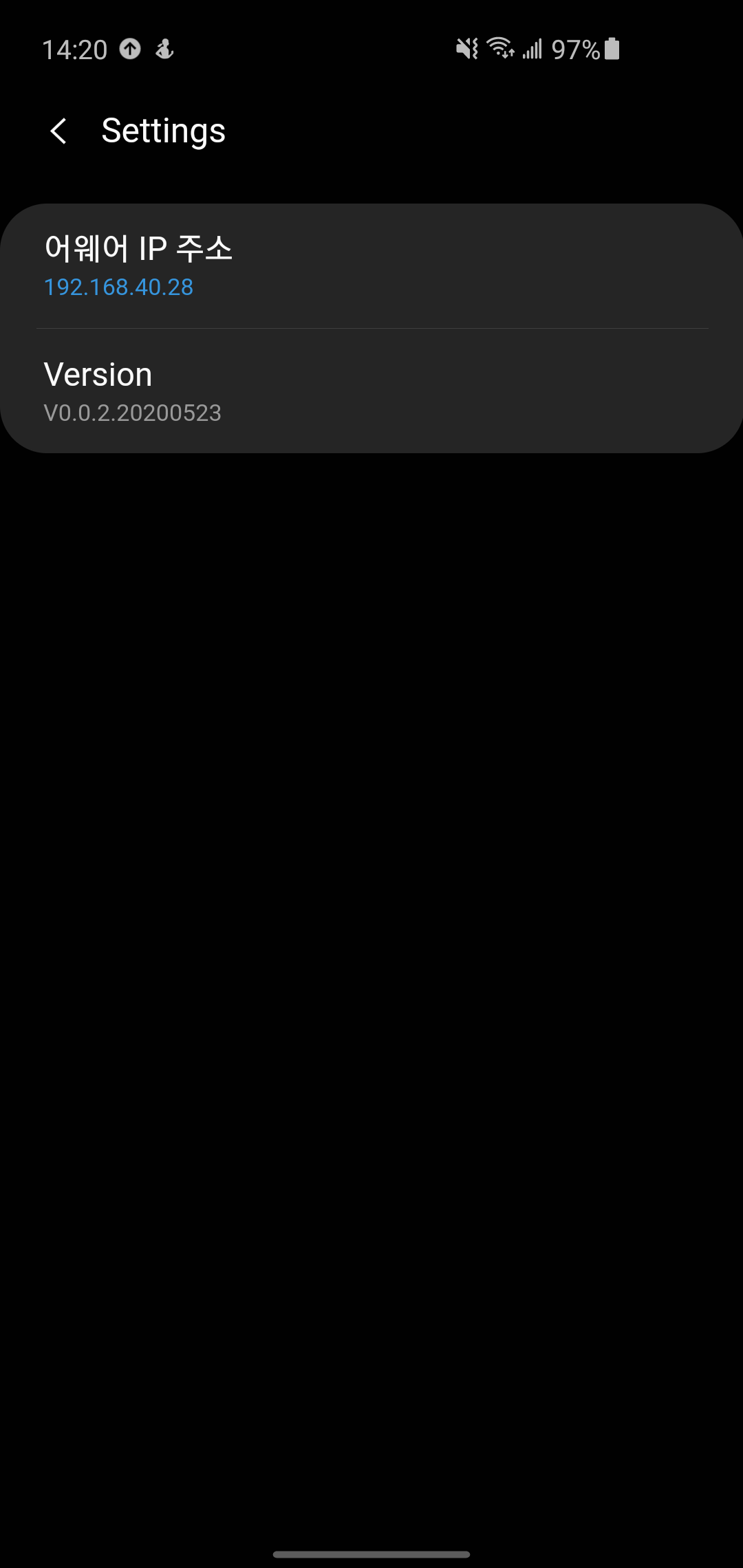

I added a way to connect the Awair locally to the SmartThings in the body.
you have to install DTH which was revealed to github by ktj1312 (Korean SmartThings user)
you can use a local connection with a smart app.
@OhJungTae
I tried it, but I can’t get it to work.
I put the IP address of my awair element in the settings.
although it asks for ip:port and I don’t know what port they communicate on.
Try 80 port
This works, thanks!
