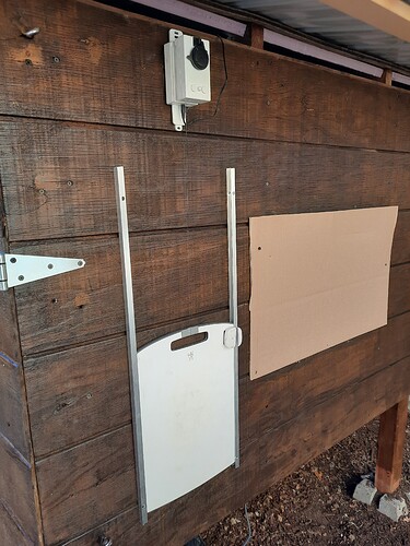

Plenty of ideas here in the community but they seemed a bit complicated. Easiest solution I found was:
I had a cutting board which slides nicely in the aluminum track. Track is from Hone Depot. So I just bought the motor on Amazon:

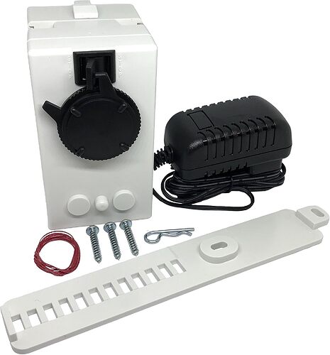

Even easier is to get the motor/door all assembled. Also on Amazon:
You just plug the motor transformer into a smartthings 110VAC outlet and you’re ready to do whatever Automations and SmartApps allows you to do with the smartThings outlet.
I did add a contact sensor to the door to confirm open/close state.
