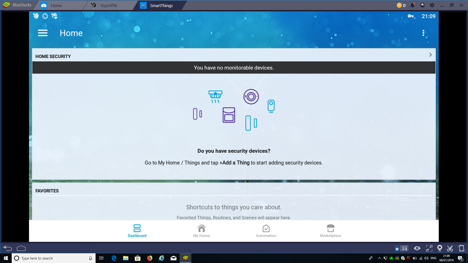

My problem is with using the app side of the adt system, this is what shows
As you can see im missing the “Home Security” buttons for ADT. I have tried creating an account with a VPN which directed me to the USA samsung page which i then created an account fine. But still wont show nothing !
Does any one know what its looking for to show these buttons ? do i need to activate the Hub with a VPN ?
You probably need the hub and your phone on VPN and functioning as if they are in the US. That is a complete guess though. My suggestion would be to look for something supported in you country. I would expect the headache of trying to work around the region issue will get old fast.
There are a fair amount of setup steps involved in that dashboard so I would expect that even though the sensors are added there may still be setup left to do.
You may he able to use ADT Tools to let you control the alarm like that dashboard with its virtual buttons and it can keep SHM in sync so you could see a status. But beyond thay I am not sure.
