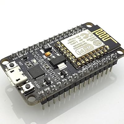

Very nice project! Sorry for the ignorance, I am very familiar with the esp8266, but not so much on the Servo. From the link you shared, how do I determine which unit is right for my blinds? Also, power in is just 5v? Thanks for the work on this!
Any standard digital servo should work, just ensure its a digital one. For example the exact model I used can be found here: https://www.amazon.com/gp/aw/d/B01CDJRA58/
And yes it’s 5 volts, I actually just power the servo and the NodeMCU with the same USB cord and a 1 amp USB wall adaptor.

I just went to Amazon and got:
NodeMCU: http://amzn.to/29Sm75V
Servo: http://amzn.to/29tOmcW
Coupler: http://amzn.to/29BHEB0
All three for less than $30!
Then I rounded up a random micro USB cable and a wall charger (aren’t these all over everyone’s houses?)
Load the code from the github and away you go!
Ah OK, wasn’t sure if you had to use an Arduino or similar.
Will take a look to see what I can find, UK has a limited stock!
Well if you already have an arduino on hand that you’re looking to re-purpose then I’d use that.
But if not I’d deffinately buy the NodeMCU instead of an arduino, it’s a fraction of the price (some on ebay are under $4!), runs arduino code, and has a built in wifi chip that you usually have to add onto an arduino!

Would this work?
Diymall NodeMCU Devkit 1.0 CP2102 IIC SPI for Apple’s MAC OS
£11.98
Oh yea, exact same board!

This is cheaper still and probably more appropriate:
https://www.amazon.com/dp/B0186N01KQ
Yea, looks like they’re trying to keyword stuff the title with IIC SPI MAC OS blah blah blah, but that’s exactly the board I used!
