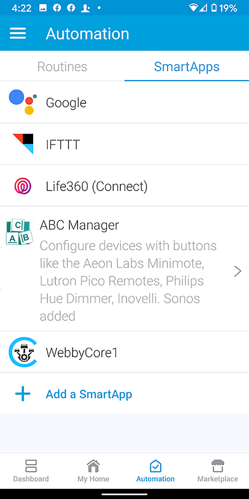

I’m new to using custom SmartApps and I’m having issues using ABC from the new ST app. I installed via the ST Classic and am able to configure button actions there. But I when I go to the new app, I can select a button but get error when I got select devices: “Network or server error occurred. Try again later.”
I saw the previous post about installing ABC (published) and child creator (unpublished). I had published both… so I uninstalled, deleted, and then re-added to IDE correctly and installed via ST Classic. But I still get the error.
Any suggestions?
I get the same f I use the new app to try to configure it. But it works using the classic app to configure it.

Yes at the moment the app is only guarenteed to work on the Classic version although I have had no problems with my setup on the new versiob if installed after the classic one. I will be trying to make it more compatiable later in the year
At the moment we cannot guarentee 100% compatability with the new app, however if youy have both new & classic installed and configure in the classic app it shoul din theory work in the new app
