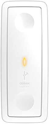

I’m using this…installs over existing switch, provides control of two Hue bulbs I have where the switch box is crazy crowded and I didn’t want to deal w/stuffing a smart switch into it. isn’t for everyone - it doesn’t blend the way an integrated smart switch would, but it’s not in a high-traffic area of my house and solved other problems, so I (and more importantly, my wife) were OK w/it.
