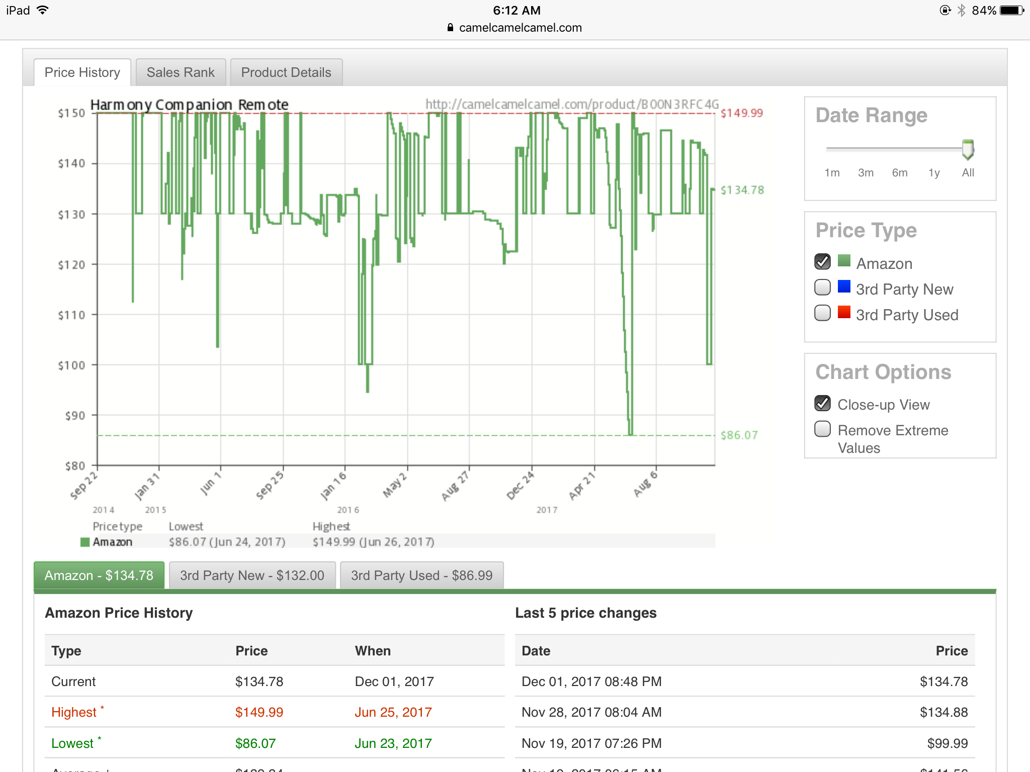

If you look at the price history at Camel Camel Camel, you can see it goes on sale for $120 pretty often, and I would expect to see that again before Christmas at either Amazon or Best Buy. And sometimes it’s on sale for $99, although not often.
Also, this is one of those devices where sometimes the black one is on sale and sometimes the white one is on sale, so if you don’t care about the color, check both. Just always check the product description to make sure that you are getting both the button remote and the hub, and not just the button remote. :sunglasses:
