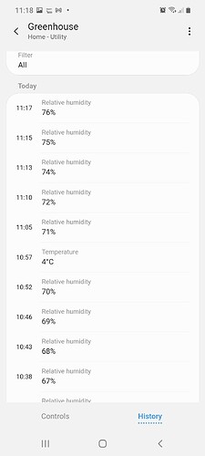

After the 1 update on humidity it’s not done or since. I’ve tried to replicate what I did by swapping the DTH, and the swapping back with no joy. Temp is still working fine though.

Ok, so I deleted it and let it add as a sonoff switch under add device>brand>sonoff upto now it’s reporting battery and change of humidity.
Wait what?
Does it report temperature?
You have it added as a switch?
Added as a switch, but it loaded your driver and shows as a sensor, everything is updating.
