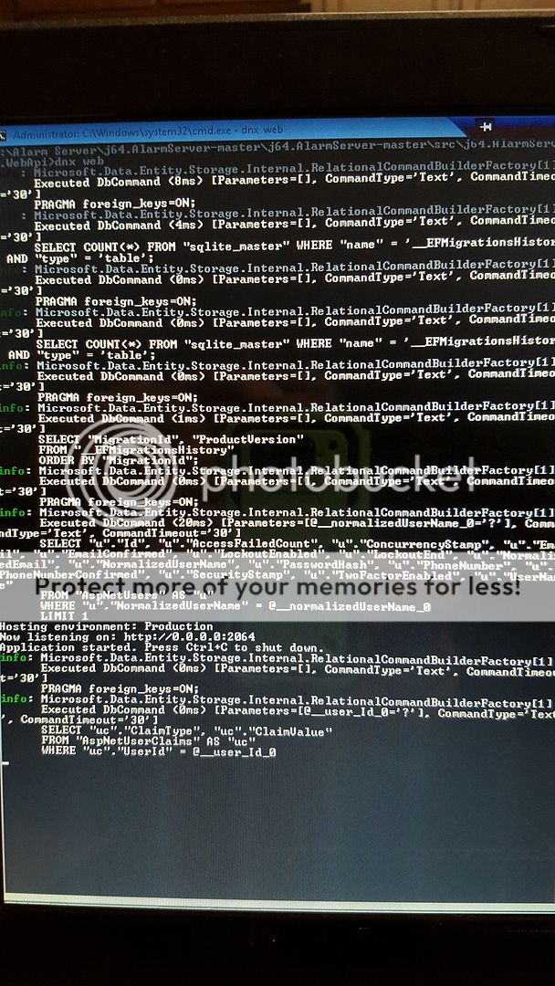

OK heh now Im getting close. I re did the web api and it built ok the second time. Not sure if I did everything the same or what but it built. Now when I type the command cd j64.AlarmServer.WebApi dnx web, it starts loading but never makes to to the part where it says Listening on http://0.0.0.0:2064 it just freezes before it gets there. elow is a picture of where it freezes.
[URL=http://s837.photobucket.com/user/Intimnasc/media/Mobile%20Uploads/20160320_130822_zpsaezowv8u.jpg.html][/URL]
Well the saga continues I have the Alarm Server running but am unable to open the local host. It says local host refused to connect. I can ping my server from my laptop but not o through port 2064 if that helps any. I am doing all this through RDP into my WHS 2011. Any advice would be sincerely appreciated. My laptop is on a wireless access point and my server is plugged into one of the lan ports on the same access point.
So please someone tell me where my stupidity has overwhelmed me.
