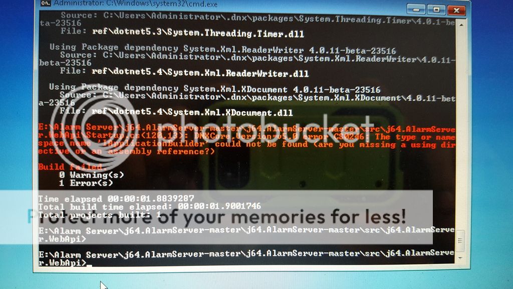

@joe64 OK I am on step 5 and I am getting the following error in red letters but at the bottom it says 1 project built but only like 3 or 4 lines of text. Is this OK?
unable to locate project .json.
OK I see whats killing me. My DOS commands. I cannot seem to change to the src directory gimme a few minutes.
@joe64 I am almost there brother please dont get upset with me. I can restore the Web API in step 5 but I get a build fail from it. Below is a picture of my screen with the build fail.
[URL=http://s837.photobucket.com/user/Intimnasc/media/Mobile%20Uploads/14584949597052133629851_zps4u4eje9g.jpg.html][/URL]
