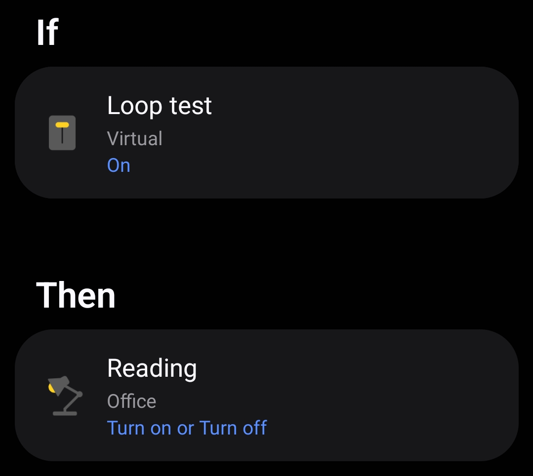

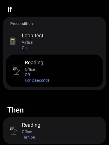

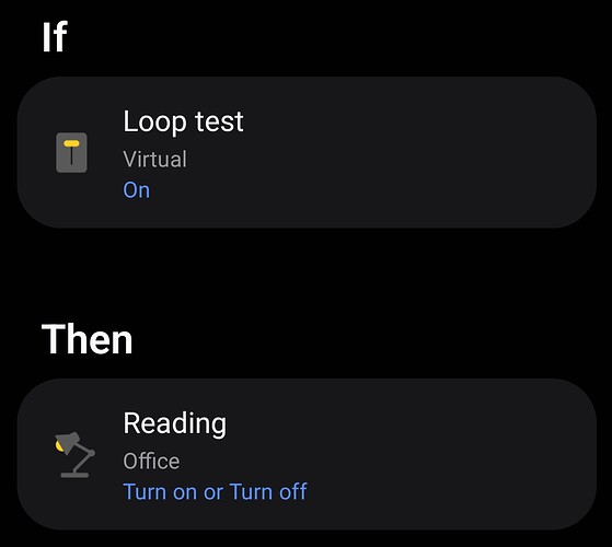

Just replied to your reddit post. It’s easy with just three routines, no hub, no custom drivers, no more virtual switches:
  1. If the switch is On, Then “Turn on or Turn off” the light
  2. If the light is On for 15 seconds, precondition the switch is on, turn off the light
  3. If the light is Off for 15 seconds, precondition the switch is on, turn on the light
