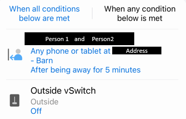

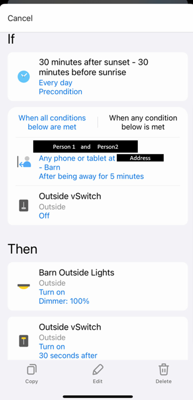

Where we live is dark! I’m trying to replace a WebCoRE piston that used to brighten lights to 100% when somebody comes home and then dim them again after 5 minutes. I’m using a virtual switch and have the following automation to kickoff the brightness increase:

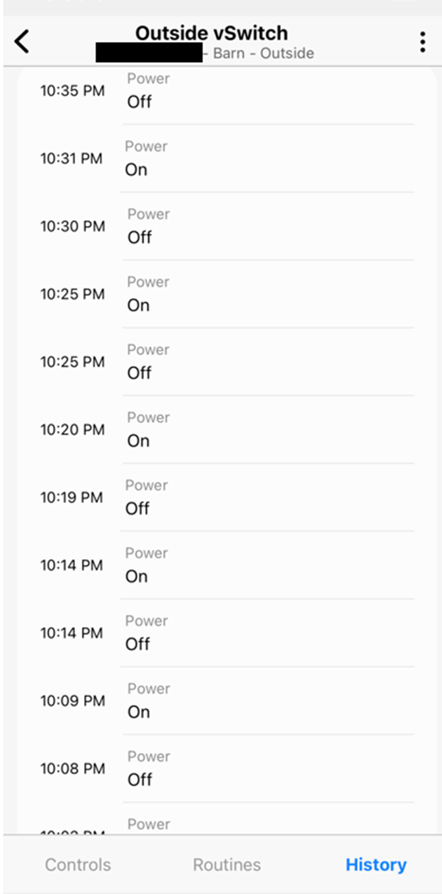

What happens though is that once the first routine is triggered by coming homes the routine goes in to an endless loop (so Off (30s) → On (5m) → Off (30s) → On (5m) → Off (30s) and so on)
This seems to imply the first automation is always running when we are home? What am I missing? Perhaps I need to use a presence switch? Curious for some ideas. Thanks in advance.
I think it’s because part of the trigger in the first routine is the vswitch turning off. So every time, the second routine turns off the vswitch, the first routine is triggered and the process repeats.
I think the trigger in the first routine needs to be something other than the state of the vswitch. What condition does the vswitch being off supposed to represent?

Thanks for taking a look, the first routine is supposed to be checking the status of the switch, not operating it:
So, somebody gets home AND the switch is off… Maybe I’m missing the point, I think I also added this to try and workaround the issue…
Are you trying to check the state of the physical “Barn Switch” or the virtual “vSwitch”? Because as written, every time the second routine turns off the vSwitch, the first routine will be triggered. A pre-condition of “vSwitch is off” would check the state of vSwitch without being a trigger for the first routine.
I think I’m checking the state of the virtual vSwitch, surely the “if” implies a check of state and not a change to that state??? The second routine has to turn off the vSwitch in readiness for the next time somebody comes home, in essence I’m hoping to use the vSwitch as a variable. Not to say that I don’t fully comprehend how this “stuff” works!
Then I suggest changing the state check of vSwitch to a pre-condition so that when it is turned off in the second routine, it isn’t a trigger in the first routine.
I just made the change and will test this evening. I’ll report back once I know more. Thank you for helping, I really appreciate it. :slight_smile:
It looks like this did the trick, I only have one data point but the behavior last night looked much better. Once again thank you for your help. I’m not sure I understand but I rationalize it as:
