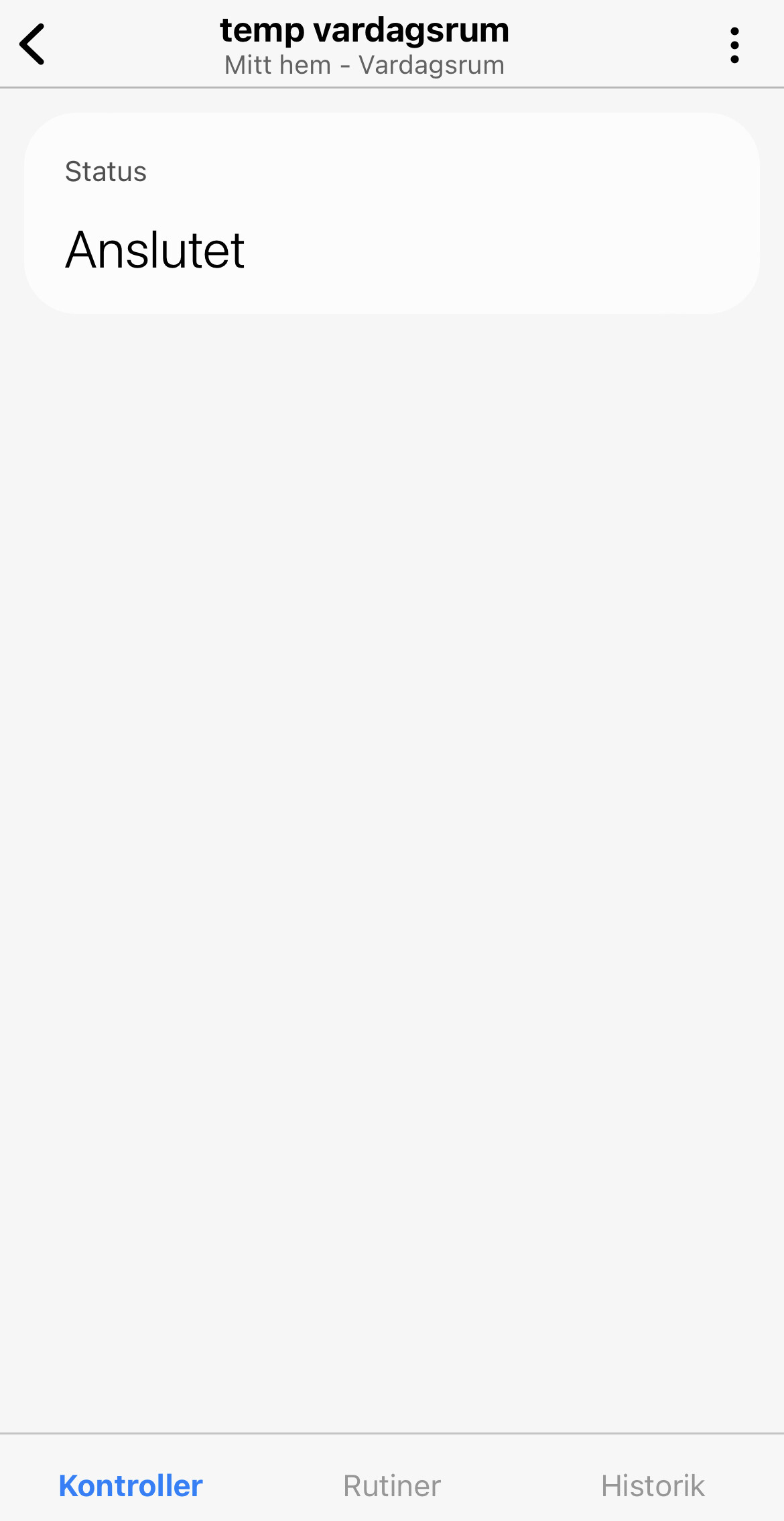

Hi, I tried to add the sensor as well.
I can find the sensor if I add device and choose Aqara Temperature and Humidity Sensor T1, it will be added as “Thing” and I can change to the device handler.
It seems to work, but I can only see the temperature under “history” the main page just shows “connected”, as shown on the picture.

I want the view that’s showing the battery and temp graph.

Thing is good enough - just change the driver in the device settings to the Xiaomi.
I got them to work after a lot of work.
I did try another Device Handler for Xiaomi and then changed back to the Xiaomi/Aqara one.
After that things started to work as expected.
The only thing right now is that the “widget” showing the humidity instead of the temperature.
Read another thread and they suggested to change the device handler to “SmartSense Temp/Humidity Sensor”, after that the temperature is shown instead of the humidity. BUT, I loose the battery status for all sensors but one.
Ok, so I got it to work.
First change to the Xiaomi/Aqara DH, then wait for the battery status to be updated.
Then switch to the SmartSense DH, and voila, temp, humidity AND battery status with the Temperature showing in the widget.
