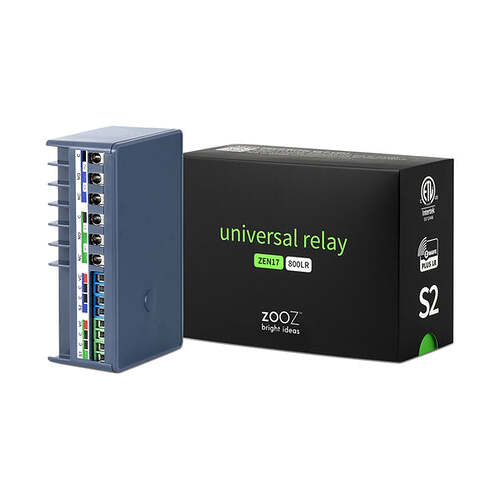

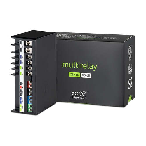

Depending on the type of actuators you’re using a Zooz Z-Wave relay might be what you’re looking for. There are two different types…
They work great with SmartThings. I have used them to make several custom devices.
