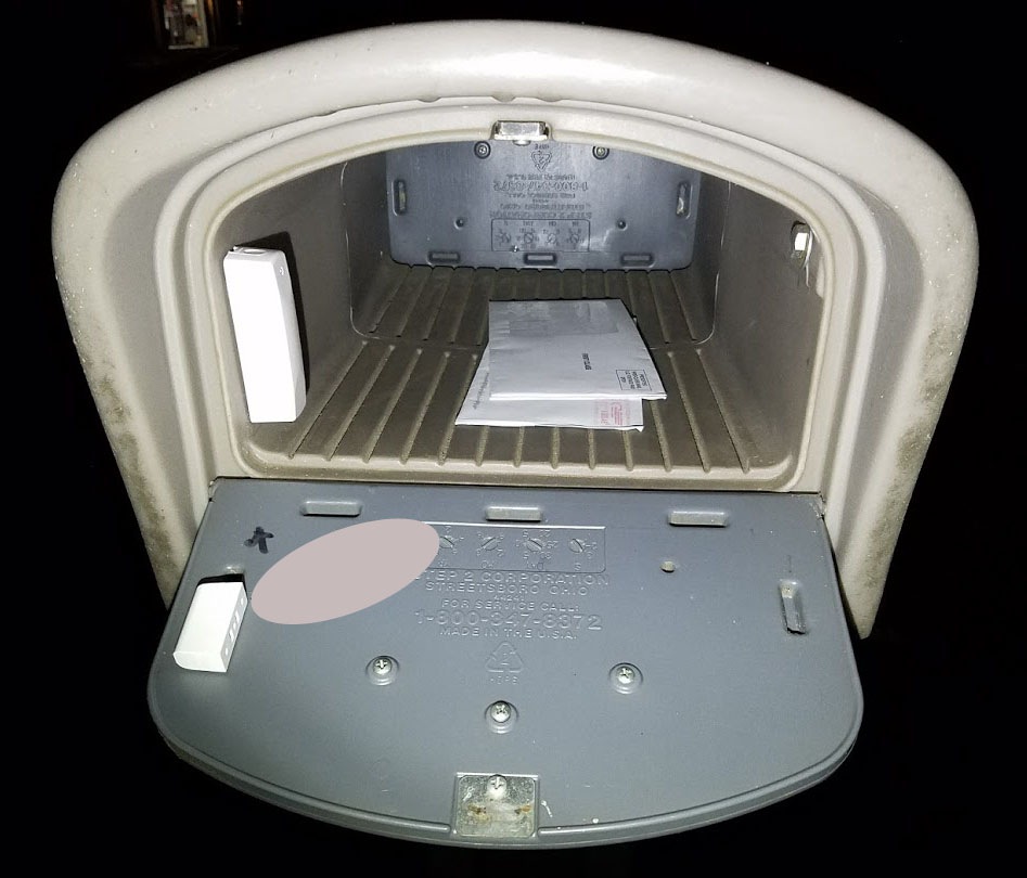

I am there with you. That’s why I installed my contact sensor under the box and used a small magnet on the door instead of the one that came with sensor:

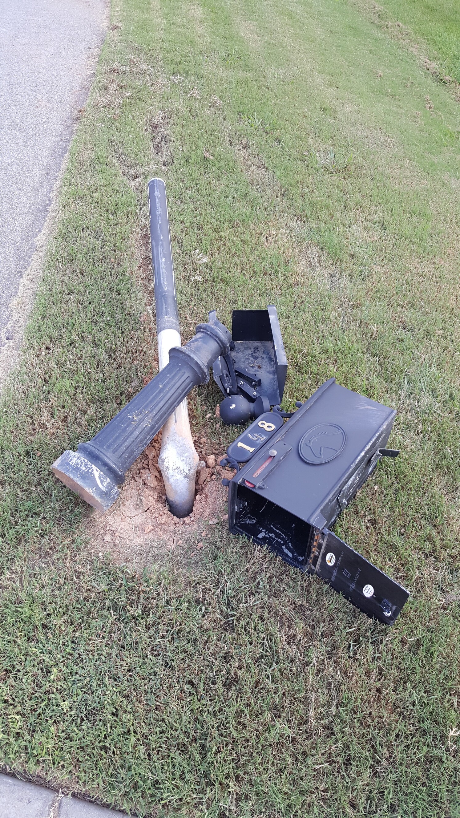

Yeah, I kind of figured you might run into that. My box is very heavy gauge aluminum. The vibration sensor also notified me of this: :slight_smile:
You should see the damage to the car!
