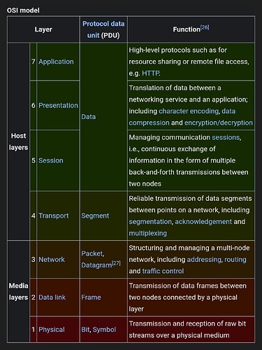

As long as you can provide the correct electrical pulses to the Ethernet port, everything else should work locally… :wink: A 1-port Ethernet switch should do the trick.
These link integrity test (LIT) pulses are sent by Ethernet devices when they are not sending or receiving any frames. They are unipolar positive-only electrical pulses of a nominal duration of 100 ns, with a maximum pulse width of 200 ns, generated at a 16 ms time interval with a timing variation tolerance of 8 ms. A device detects the failure of a link if neither a frame nor two of the LIT pulses is received for 50-150 ms
Physical Layer, no network protocol involved.

Did you read everything written above? It doesn’t need an actual external IP network, because as long as the ST hub is connected to an Ethernet switch (physical layer, no IP whatsoever) it works.
Doesn’t IP mean router?
No.
You don’t need a router to create a network of IP devices. What you need is a simple network hub (difficult to find nowadays). They can communicate with each other just fine. If you want to connect them to a different network (Internet, for example), you’ll need a router.
