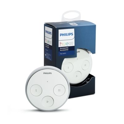

@smart - what are taps?
Philips tap is a device to switch on Philips hue. It doesn’t have batteries. And can launch scenes that you have set thru the Philips hue app.
