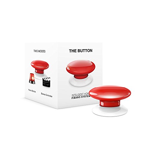

Big red button :wink:
The Fibaro button itself looks great, but just isn’t reliable enough, let alone when combined with smartthings. Lots of complaints from people that they have to press it multiple times to get a response. :disappointed_relieved:
If you’re planning for a situation where someone might die if everything doesn’t work just right, the standards are set much higher than for a typical home automation device.
This DTH seams to be working fine, but YES, mileage may vary and I agree that Smartthings should not be used for life and death situations in general.
Well, the reviews aren’t great, but there’s an improved handler, so maybe I’ll give it a try at my house first.
