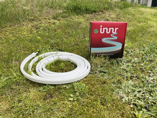

  2. Because you are in Europe, you also have the option of the INNR outdoor LED strip. ( this is not yet available in the US.) It’s clearly intended to be a cheaper copy of the hue strip. It looks similar but the features aren’t quite as good. In particular, for your case, it’s only about 2/3 as bright. So I don’t know if it will work for you or not. It’s also a much stiffer strip, which makes it harder to bend around a doorway, if that’s what you had in mind. And it’s not quite as waterproof at the point where it connects to the power cord. also, the colors are not quite as rich. But it is definitely a lot cheaper.
Here’s a good review of the INNR Vs the Hue well you can definitely see the difference in brightness. The difference in color is not as obvious because the guy who made the video has both strips coiled up, and that tends to hide a lot of the color. (The video is in German. Those who need English can get English subtitles.)
Innr says on their website that you can use the INNR products directly with a smartthings hub without needing a hue bridge. I haven’t seen any reports from people doing it that way, though, so I don’t know if it will require custom code for color management. I think it would be doable, there are none of the issues that you get with, say, Tuya, but I did want to mention the possible issue.
