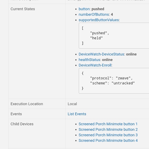

@johnconstantelo - The new app needs the buttons separately (I don’t even think they need to be child devices actually) where you can assign them directly, but in the classic app those buttons are just available in the automation without a child device. If there are buttons available as an attribute on the device like your screenshot, smart lighting will see them. And, as brad pointed out, there’s a code limitation in smartthings.
