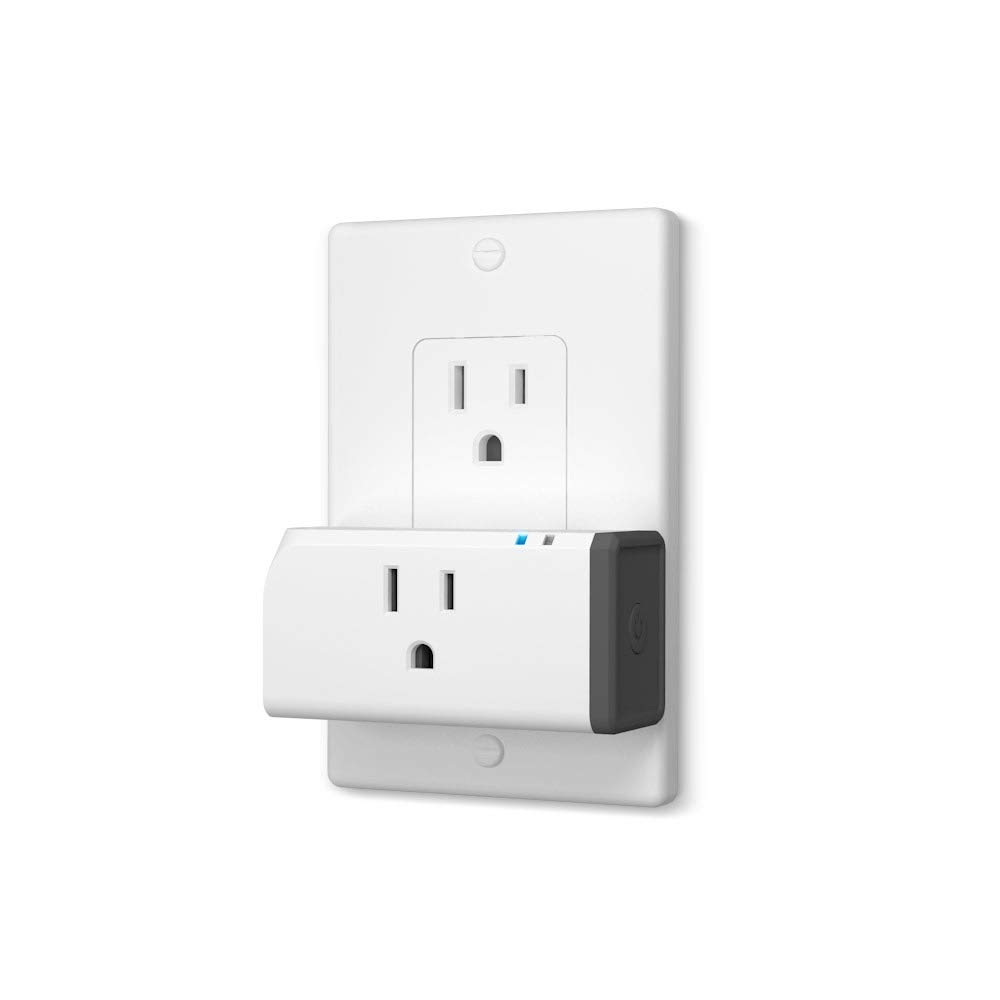

The sonoff zigbee plug is also a zigbee repeater, affordable and has a little better form factor that the ikea plug IMO. (This is an affiliate link)

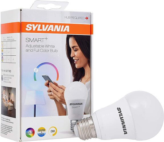

As for bulbs that repeat, I use Sylvania Smart+ zigbee bulbs and find them to work well. Looks like the full color model is on sale right now
