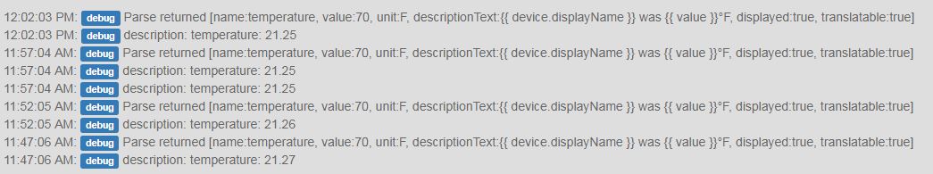

So it appears this did not work the way we thought. Under the recent tab for the sensor it does not list the new expected intervals of values and neither is my data logger seeing them. Any ideas if there are other ways to verify that the new script is working and/or doing what we intend it to do?
open live logging in the ide and leave it open for a while to see if the sensor is actually sending events
Sorry - I gave you the wrong parameter. Use map.isStateChange instead.
just “map.isStateChange” or does it still need the “=true parameter” behind it as well?
map.isStateChange=true

The humidity one is in the right place. Are you seeing a log in the IDE indicating it received a humidity report that isn’t showing in the recent activity list? That would be an indication that the isStateChange isn’t working.
From the logs you posted, it looks like the device is only reporting humidity to your hub once an hour, currently around 7 minutes after the hour. That matches what @Automated_House said as well. If each hourly report is posting, then your code is fine.
Some devices like this can be sent a configuration command to change how often they report. I don’t have one of these (or anything similar that speaks zigbee), so I’m not sure how to do that with this device. It looks like there’s some information at https://docs.smartthings.com/en/latest/ref-docs/zigbee-ref.html under the zigbee.configureReporting command, but I’ve never played with it.
I think you are right, I am going to let the logging sit for a bit longer so we can see over an hour’s worth of data but you seem to be correct.

playing devils advocate here before I change that value, why is the temperature reporting every 5 minutes versus humidity every 60 minutes when seemingly both intervals are set for that 60 minute mark?
Logs attached and full current code in case that helps

I think the zigbee.configureReporting line is controlling humidity reporting (3600), while zigbee.temperatureConfig is doing temperature reporting (300).
Gotya, I am going to set it for 7200 first and see if it does what we want and then adjust to the larger number. It is just on the bottom that I would have to adjust the numbers right?
