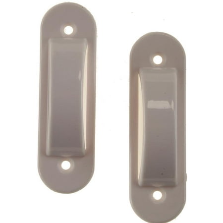

you could do low-tech and just guard the switch, allowing manual override by your pinkie
I have one wall switch guarded. It’s enough to prevent casual operation.
